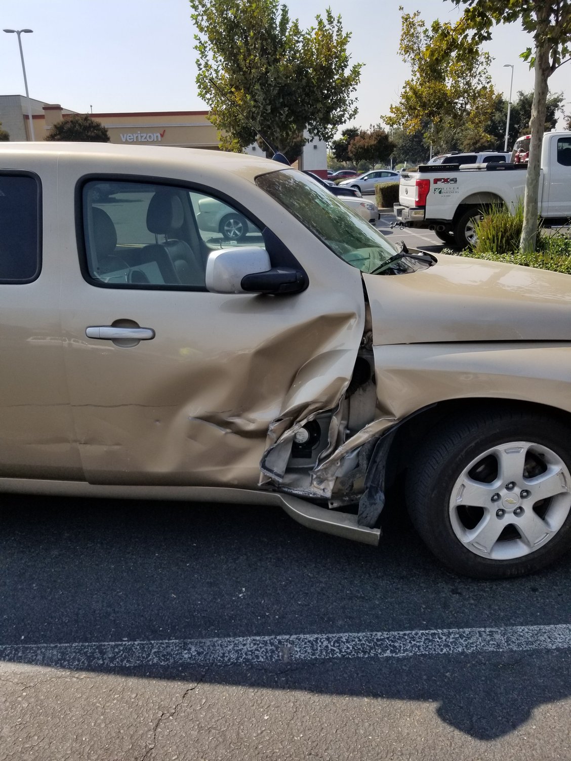

So this past weekend as I was driving home and long story short BOOM
Anyone know what tools I'd need to remove and replace both the door and front quarter?

Looks like you are gonna need a passenger front door, and fender. A 3/8 drive metric socket set and a combination wrench set also metric should do you, HF has them pretty inexpensive.

Can't tell from the picture but I'll guess the airbags did not deploy ? If they didn't, then it should be an easy repair of a door, fender and the lower rocker panel.
If the airbags did deploy, that opens up the problem of replacing those and the control module for them.

It appears the door skin peeled back , I can see the speaker basket , so hopefully the hinges are not damaged.

That is correct, fortunately the impact wasn't too hard to set them off. I really hope the hinges and frame aren't bent back, my roommate used to work on cars so hopefully he'll have more feedback on the conditions 😬
