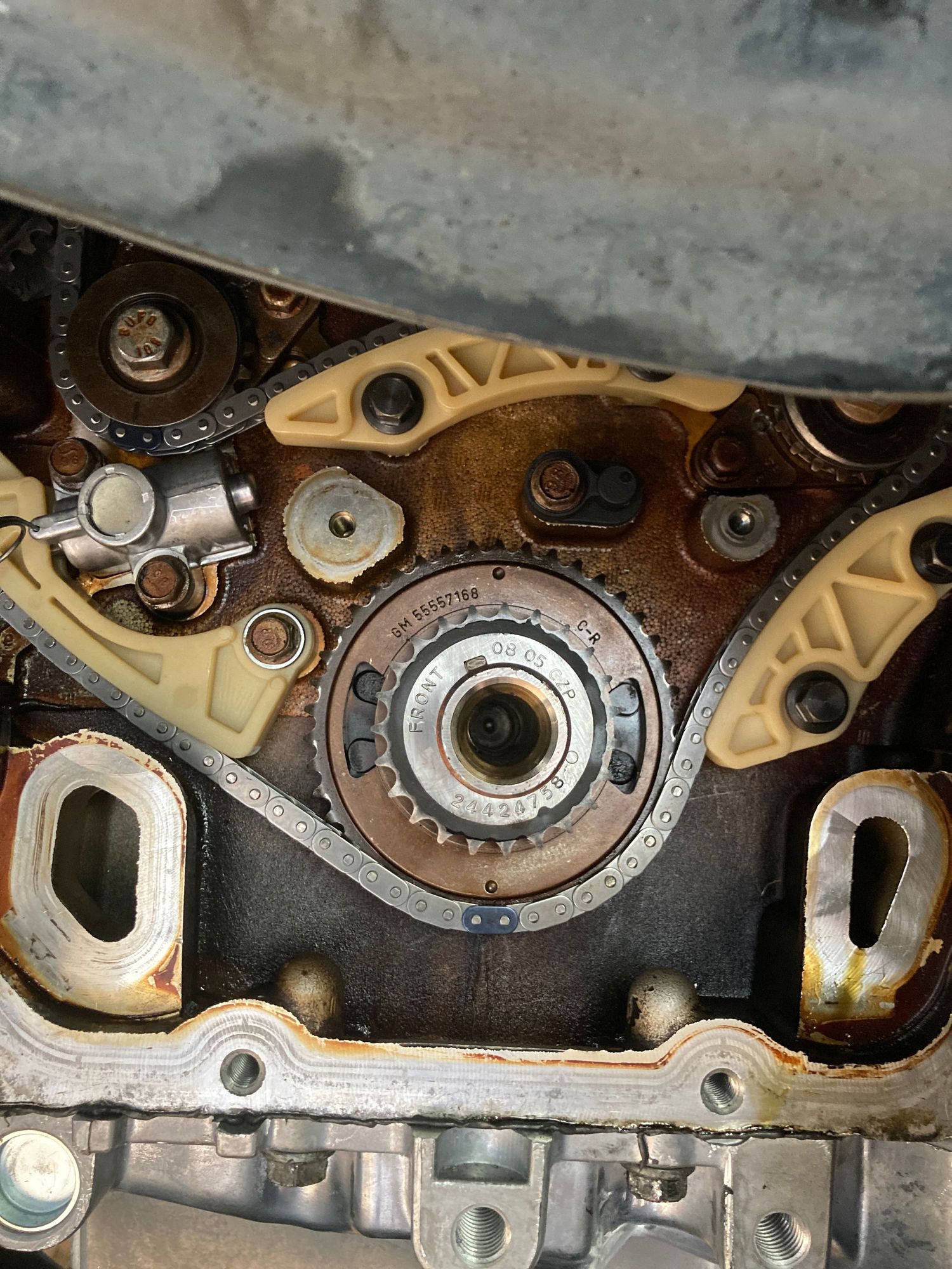

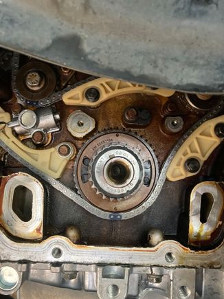

You can see at the upper left the exhaust balance, chain color link is in line with the mark, the same follows for the intake side. Crankshaft sprocket from what I read is supposed to be at the 12 o’clock position. I just have a gut feeling something isn’t right.
