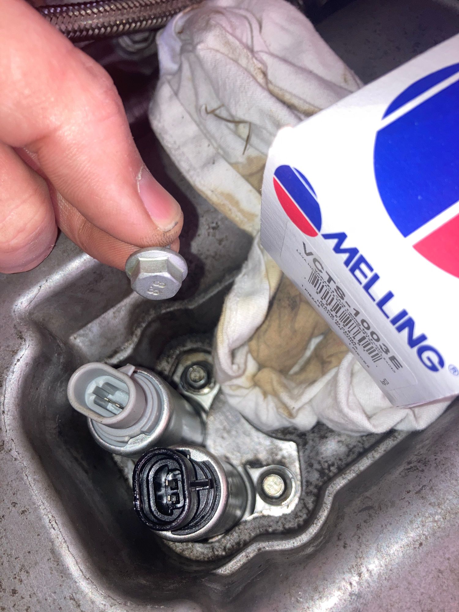

The Mellings kit that came with the VVT sensors included a 10 mm bolt instead of the original 8 mm. I use the originals torque to 89 inch pounds. Hopefully nothing sneaky about this.
