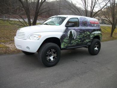

This may not be an HHR but this is similar to what you are wanting to do. It pretty much was just sitting atop a 4x4 frame from what I could see. In this pic you can see that the rear diff is still in the same spot in relation to the frame. The engine was also located in the same place it was when it was still a truck, up front. I would expect that they had to relocate the gas tank and had to cut out the pan area up front of what would be the firewall. In our cars this is already open and the tank is towards the rear and does not protrude below the bottom of the body.

This one is on a shortened Chevy K-5 Blazer frame.
