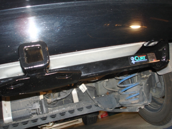

After much trial & error, here is the shot of the bolts & spacers in the correct position:
Next I got under the back of the car & lifted the left side of the hitch up & into position over the muffler. I let it rest on top of the muffler & lifted the right side up & carefully started the nuts onto the exposed bolt ends. This was difficult because I was on my back, holding the hitch up with one hand & trying to thread a nut onto a loosely fitting bolt with the other hand. I had to start & stop a couple times because the hitch was so heavy. Lots of moving the hitch around & trying to start the nut onto the threads without pushing the bolt up into the frame rail. This is one of the places where a lift would be a big advantage! Finally I got all the nuts hand-tightened:
The instructions say to slide the hitch over to the passenger side & then tighten & torque to 75 lb/ft:
Trailer Hitch Installed:
Tounge installed:
The ball I got with the trailer didn't fit the tounge. I had to buy a 3/4" shank, 1 7/8" chrome hitch ball (mfg: Reese= $10.76 at Advance Auto parts):
Overall the job took about 1 1/2 hours start to finish!
I hope to go ride my dirt bike this weekend with my new trailer! Proud pictures to follow...
