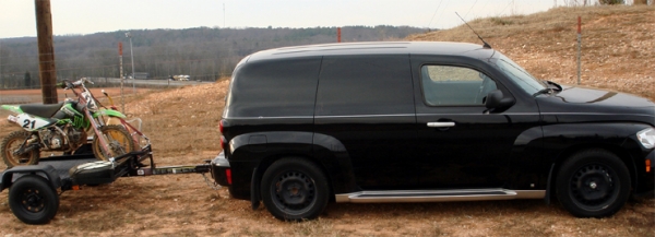

I went to the motocross track in Blacksburg, SC. Here I am loaded up for the trip home:

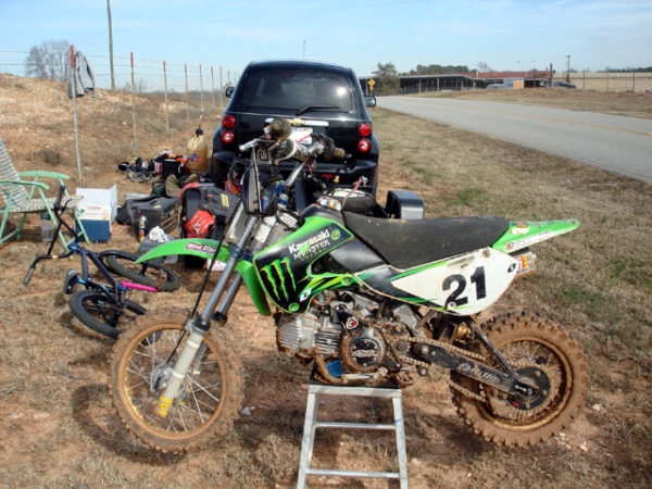

Here's my pit area after my first ride. The track was a bit muddy in spots:

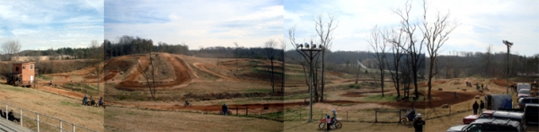

Track pic:
Overall impressions of driving with a trailer. Luckily I did not have to back up anywhere. I'm sure that would've been interesting. I've got to get out to an empty parking lot & practice!
You can feel the trailer when you go over bumpy roads. It kind of jerks & bounces along the roadway. The tounge fits quite loosely in the reciever. This slop was quite annoying as the weight of the trailer magnifies this movement to where it's banging everything side to side & up & down. I needed to find a shim of some kind to get rid of the sloppyness. I started layering strips of duct tape on each side of the tounge until it fit a bit tighter than before. It's not perfect but it's better than before.
Overall the trailer was a dream come true. I made it to the track & back without a problem & look forward to many more trailer trips in the future!

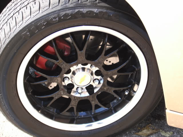

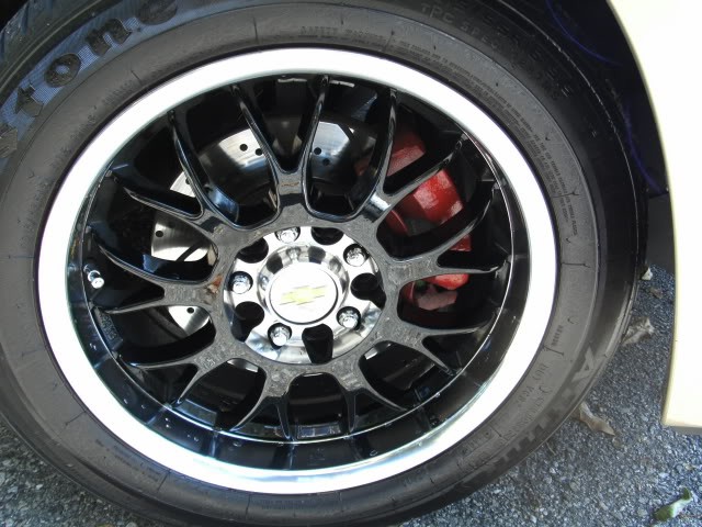

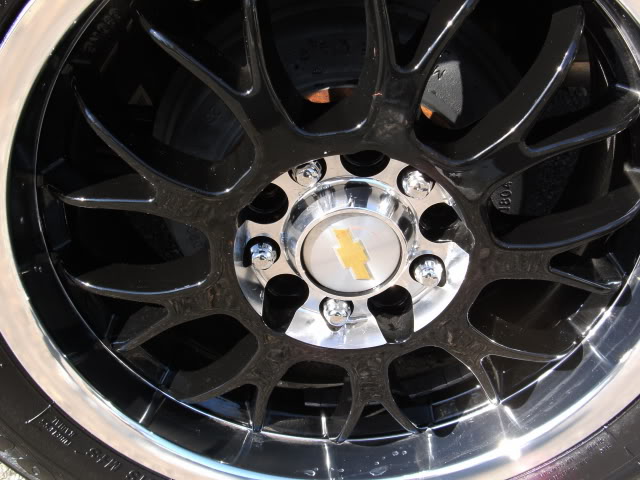

Originally Posted by bilko
That looks GREAT!
By the way, What are the wheels you have, and can you post a close up?
I'm looking for a set , and I like the way your wheels look.
Voxx Monza from Discount tire,used my stock center caps instead of Voxx caps.Caps sit inside hub,glued in with clear silicone.
