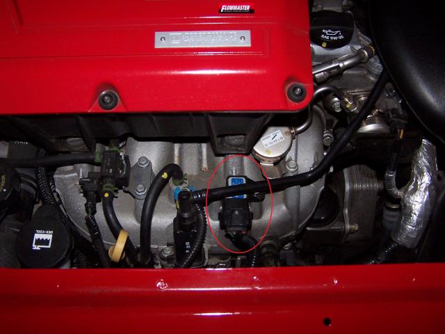

Quick way to verify; look at the top of the MAP sensors and see if the sensor is marked with a sticker. Blue and white sticker means 3 bar MAP sensor and GMTU.

Posts: 11,721
This:
Name:  Bosch Sensor.jpg
