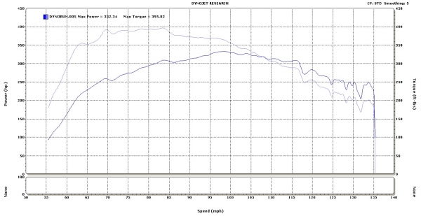

Adm Enhanced Gm Stage Tune
Well here is what we came up with.
2008 HHR SS-
ADM 3" Stainless steel exhaust systenm
ADM 3" Stainless steel offroad downpipe
Magnaflow 3" Stainless muffler
Spearco Intercooler-Custom fit
ADM 3" Stainless steel Intercooler pipes
Tuning by ADM PERFORMANCE at HPP MOTORSPORTS in Lewisville Tx.
DYNO WAS INTENTIONALLY SCANNED USING STANDARD CORRECTION FACTOR.THE ONLY REASON I DO THIS IS BECAUSE ALL THE OTHER TUNERS THAT TUNE THESE SEEM TO FOLLOW THE SAME GUIDELINES.I WILL POST IT IN SAE IF NEED BE!

Hot Damn Andy!!!!
What are you using for a Clutch?????????

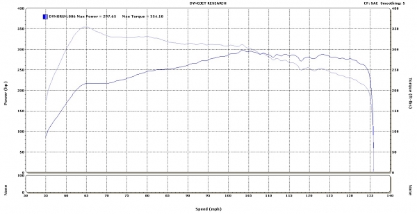

Gm Stage Tune Only
Here is an un modified gm stage tune dyno:

Do you think you could see this with the stock intercooler?

No,remember what I told you about the stock intercooler
