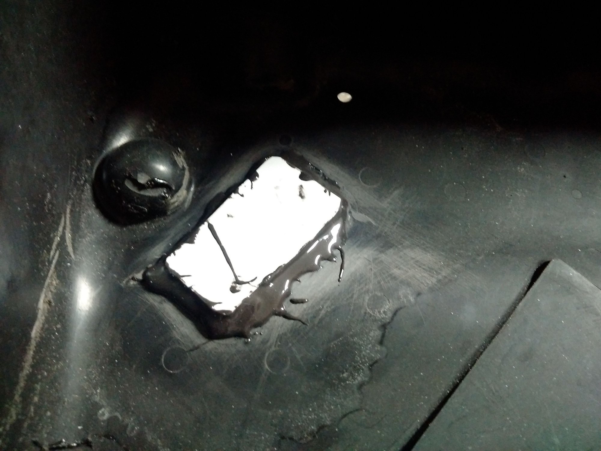

This little mod gives your SS much more air flow, and much less cleaning while keeping the cold air box. You must already have a K&N kit with K&N air box cover for clearance. This simple mod allows for a K&N RX-2820 X-Stream flow filter. This filter is one inch longer, larger diameter, with additional filter material on the end. Requires cutting out the stop in the bottom of the air-box, covering the hole with a piece of plastic held in place with JB Weld epoxy glue, and wrapping a piece of 3M double sided tape with only one side of the tape covering removed onto the inlet to take up the minor difference in the filter inlet size. It fits snug, perfect. If you are not running 20+ boost this is not a benefit. This baby flows!. Also the original K&N filter had an internal lip on it to further decrease the flow. Yea i slipped with the cutter Lol, and made a mess with the JB weld, but then who can see it.

Nice! Do you have the RPD or some other way to see an increase in HP or torque?

It’s still gonna ingest as much CFM as the charge pipe will flow, but that might be more then the original or first K&N filter would allow.
Nice mod, but don’t cut hair or outer body work!
Hay, I like this, & I decided to give it a try...
You don't have to mod the airbox at all...
It fits just fine...
I just used a screwdriver to force the end of the filter in front of that 'bump' on the floor of the box...
The K&N lid has a little flex to it, & holds the filter in place very well...
Now to the testing...
IT WORKS VERY WELL
I can 'feel' smooth increases thru-out the full RPM range...
The stock filter & the stock K&N filter that comes with the K&N air filter kit 'feel' pretty much the same, so I figured that there wasn't anything else to 'gain' here...
But I was wrong, there is more to be 'gained' here by using this larger K&N filter...
Thanks to 'drspock' for making this discovery....
And 'drspock', you are too modest, as this is not a 'little-mod', it's a GREAT MOD
