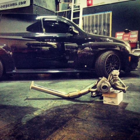

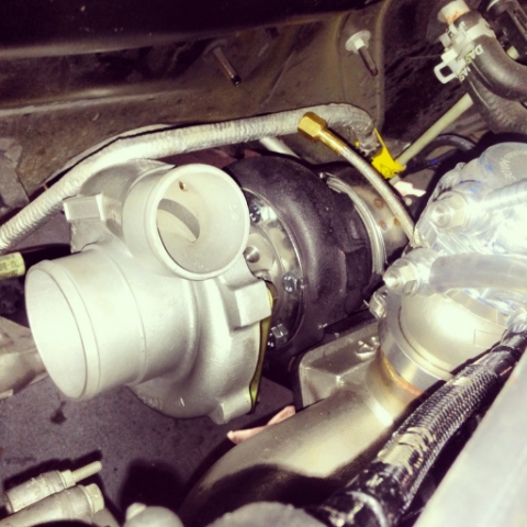

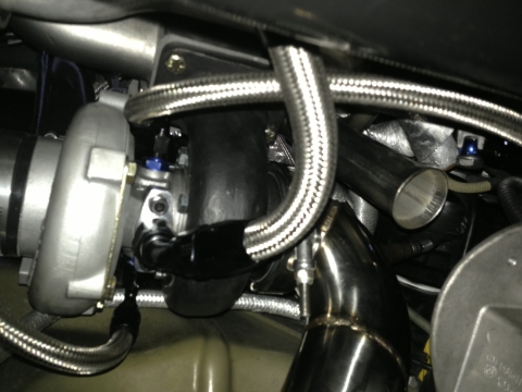

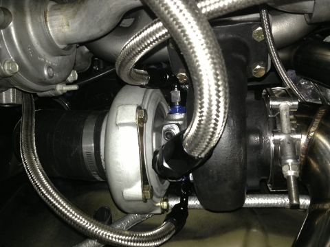

Well guys it's been while since I posted but to update. I upgrade to bigger turbo. I went with garret gtx3076 and build my own kit with some zzp parts. Here are my mods: dejon hot side pipe, greddy type s bov, zzp intercooler, zzp coldside pipe with maf relocate, zzp intake, custom 3" catless down pipe, open tail wastegate, dual side exhaust with magnaflow muffler, hptuners by James rakes,
Ky stage 3 clutch, traction bars, drag bags, pedder springs and etc. This turbo flows about 51/52-48-49 lbs per min. That's roughly 510chp-480chp.**It does fell like it lol. Right now, I am dail in on 93 then I'll be doing 104 race gas next. Here's a pull on 93 which I am running out fuel on 93. I have cams which I'll be installing next year.
Ill post more pics later today.

Here some pics.

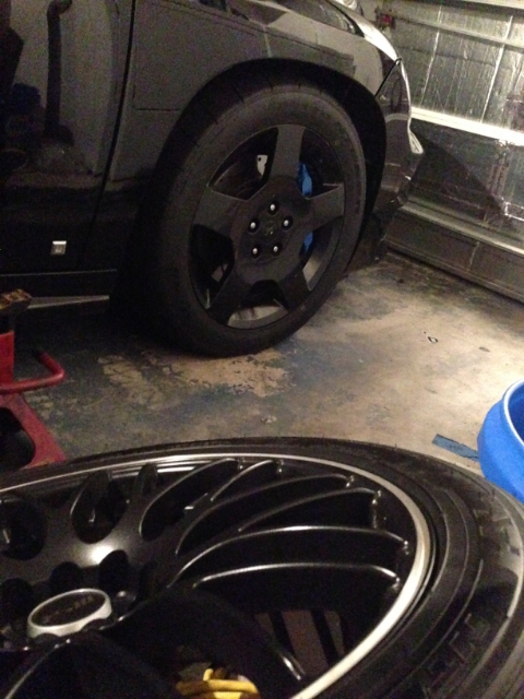

Installed the drag radials getting ready for the track.

Going order up some m&h slicks next year when come tax time. They are the only ones offer m&h slick for a 17" wheel. I don't want to get rid of the brembos just yet.
