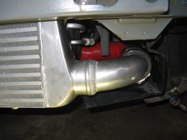

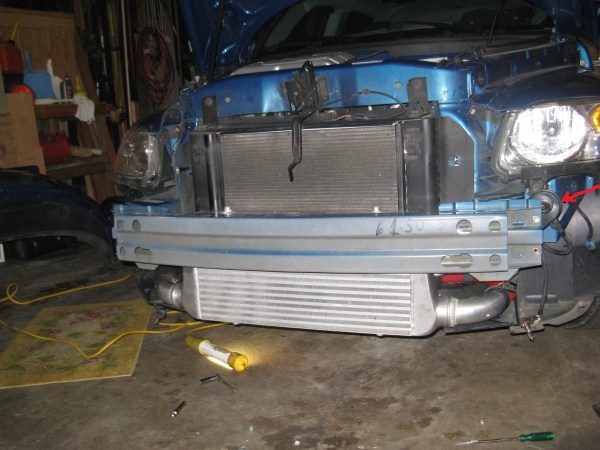

How does everyone have their CSI intercooler mounted up? I tried mounting mine yesterday and realized that not only did it not line up right but I would need some mounting hardware to properly mount it on the bumper mount.
For those of you that have this can you please post up install/mounting pics if you have them?
I've read that some people have had them mount up perfectly and others have had to modify the mount or fab something up to get it to mount properly. Any help would be great on this. Thanks guys

Talking about me again ? Mine came with a couple spacers and a couple bolts with washers to bolt into the hole that the crash bar mounts too, they take the place of 1 of 4 bolts. The left side is tight due to the end cap in the air conditioner cooler. Just take a needle nose and adjust the brackets that hold it to make a little more room. Put the bumper back in , go racing !!
Robb Them 265's look mean !!

See I bought mine used on here. I did get any mounting hardware with it. That explains a lot lol.
I'll be able to fab something up easily. I was mainly wondering if it was supposed to come with mounting hardware. Thanks guys

Got mine same way, He sent the 2 bolts with a few washers and a couple spacers which hold it back from the crash bar, the brackets are easy to adjust.

Mine bolted right up....BUT as a warning...it fits really really tight..

I'm sorry. I meant it came with NO mounting hardware. I'll just pick up what I need. I might have everything I need just from having miscellaneous parts around but I didn't have time to play with it yesterday.

It is tight, but this one isn't pre lubed.
