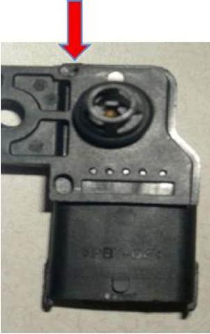

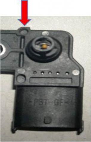

The one you ordered is the one. The second one is the kit with the crimp connectors that will age you before your time. I only wish GM was selling the one you got when I did the mod 1-1/2 yrs ago ! Good luck with it, you will love the change it makes. Make sure you chat with the tech that will install this BEFORE. Make sure that the tech knows the lower sensor must fit flush to the charge pipe which may require the sensor to have a tab trimmed off. The old kits required that to be done, not sure about the new ones. But your stock charge pipe definitely has an anti-rotation bar cast into it which will interefere with the new sensor if the small boss isn't removed by the tech (if the sensor has the small boss on it). The instructions will be (or should ) be very clear about that. The attached photo's indicate what needed to be done with the kit GM provided for mine. The other thing to watch for is to make sure the Tech provides good clearance with the lower sensor wiring adjacent to the A/C compressor. If the cabling is too close there it will chafe and F/U your wiring.
