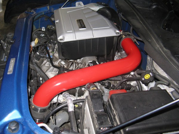

The dejon downpipe is my next purchase. I already have the GMTU and a dejon intake. Just not sure if the downpipe is worth almost $300.00.
What do you think? Other quality options?

I have one and like it bought it used got it to get rid of the rubber snake, so I can tune more boost.

/\ That's not a downpipe
ummm
ZZP
Clear Image Automotive
Badmab
Modern Performance
Over the Top Performance
etc.
ZZP would be your best bet for a stainless downpipe with no cat.

Yeah, Thats the HOT SIDE IC PIPE.
With any DP your gonna have to re-tune, or risk a reduced power CEL, and several O2 related codes. even with a hi-flow cat.

Its the thought that counts. Thanks anyway SS fan.
