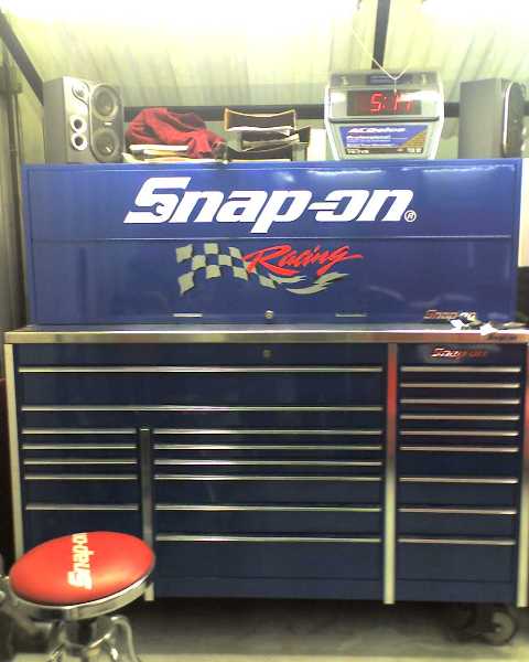

Thanks Eric for showing off my box. Here is a better picture. Yeah the dyno didnt go that well. I think I have an issue with the wastegate rod, butnot sure. I need to go back and remeasure it when its cold.

That's a sexy box.

Thank you

Helps when father in law works for snap-on..blah blah blah.....Turbotech keep my turbo upgrade safe guard it with your life and then some...see you on the 27th...For turbo upgrade and short throw shifter install....
