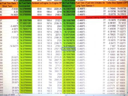

well bad news for me looks like the P101 code will be haunting me soon this is about the fifth day of driving and no problems it even went through its second car wash at delta sonic but unfortunately after about an hours worth of driving on an off driving along in about 55 miles an hour it seemed to buck or misfire quickly then no boost available.
I was data logging at the time with my torque app running.
This was About 30 minutes after car wash.
Pulled tmap harness and tape off looked great no sign of moisture and PlastIdip looked great.
Cleaned MAF disconnected the battery for about 15 minutes.
put back together seemed ok backed out of driveway and it stuttered and shut off limped it back in my garage.
I guess its possible it got hit again or moisture or was it a flook
Could someone look at my data log if so please email or I'm me and I will try and send it.

Well just an update and looking for some help
car ran great all last week after taping up lower tmap harness that was broken
Friday afternoon car started to run poorly again.
P101 and P106.
Keyed off ran ok for a little bit.
Got it home put in new lower TMAP harness adapter from Crate Engine Depot.
car sat about 4hours before I drove it ran great Friday night.
Saturday
and even Sunday on a trip that was one hour up and one hour down.
This morning ran fine and actually started to die on the highway had to pull over car was barely running keyed off and seemed better but still not exactly right.
I noticed the second car started running rough it was still commanding 14.08
but was measuring close to 21 plus
I have it all data logged. I can probably attach a screen shot here or I can email the whole log to someone. I can bring to dealer but at this point it is an on off thing but getting worse just dont want to get stranded.
Any ideas would be great
Tried different MAF seems to be having the same issues.
are we possibly looking at a bad TMAP sensor or bad O2 sensor or is it time for me to give up on this car. I cannot tell you how many hours I have wasted
trying to diagnos this issue.
Dealer just says bring back when it is happening or when you think it will happen.
Time for another dealer maybe?
I am guessing one of you tuning experts can figure this out.
Having trouble uploading Log and or screenshot but I can email them if someone could help me out
