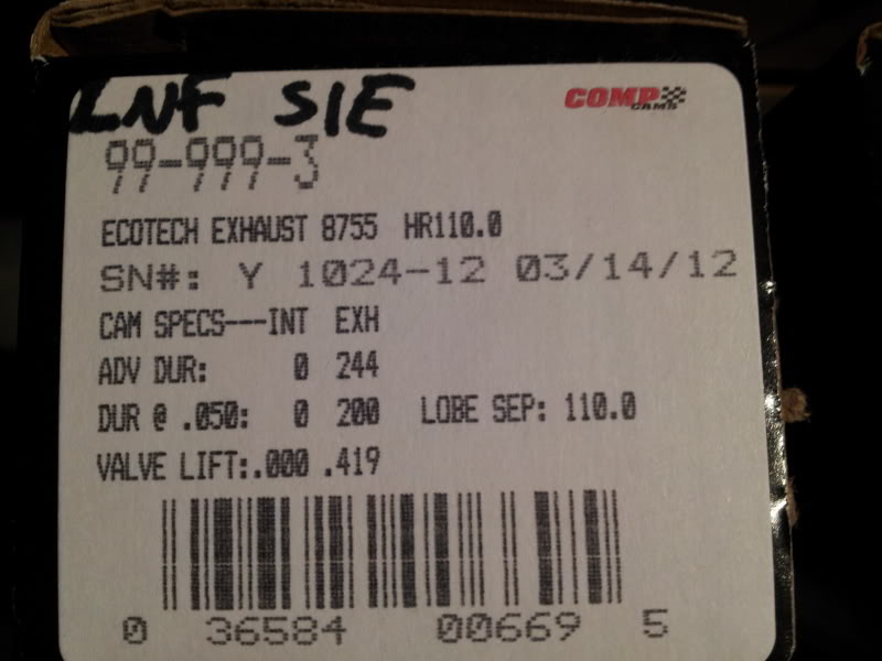

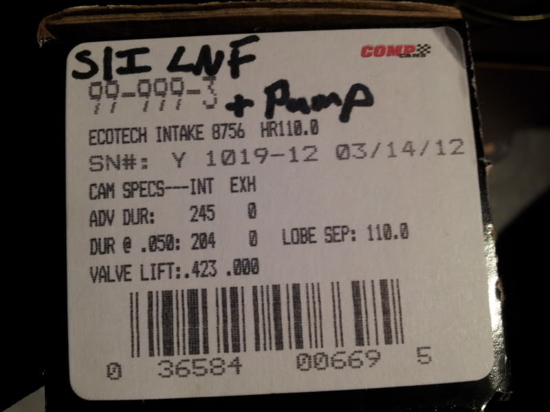

Hubby is deciding to play nicely here you go: Since the files wont upload here......

it is not as simple as calling up comp with our part/grind numbers and getting our cams. we (ZZP) has a couple years into perfecting the cams, i guarantee you will get the wrong ones if you contact comp directly. our specs have never been secret,
Duration at 1mm lash Lift
Stock cams 203.6 int duration .406" int lift
194.0 exh duration .406" exh lift
ZZP Stage 1 212 int duration .424" int lift
206 exh duration .420" exh lift
(notice this duration spec is @ 1mm lash, the box is at .050, thats why the numbers are a few * different :) )
^^^taken off of our LNF S1 cam page. i see where you are coming from in thinking that its as easy as getting the grind numbers and calling comp, but it simply is not...that is why we leave comps stickers on the box, and cam card in the box.
