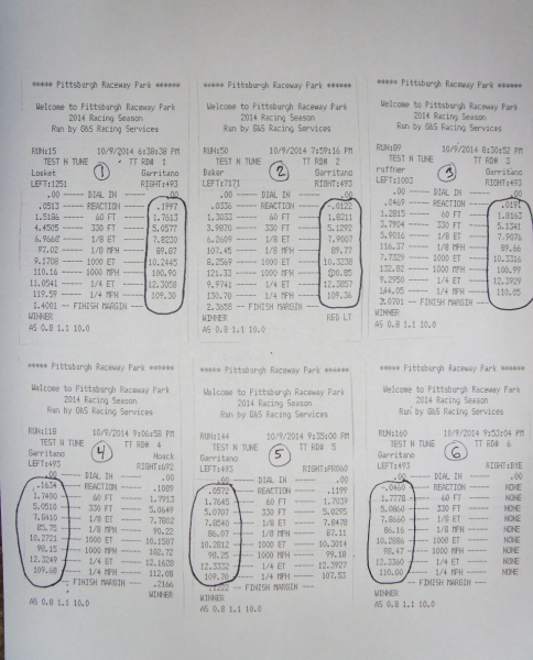

Yes, I did make it to the track the next day 10/9/14.
Yes, the 3" muffler/resonator did help.
At 1st, when looking at my logs of my runs down the track,
I really didn't see anything that stood out, until I realized that there
was a very slight change in acceleration...
A good night at the track, 6 runs, all in the 12.3s,
with about a 1 MPH better trap speed, compared to when I ran 12.4s,
the last 3 times out at the track last year.
