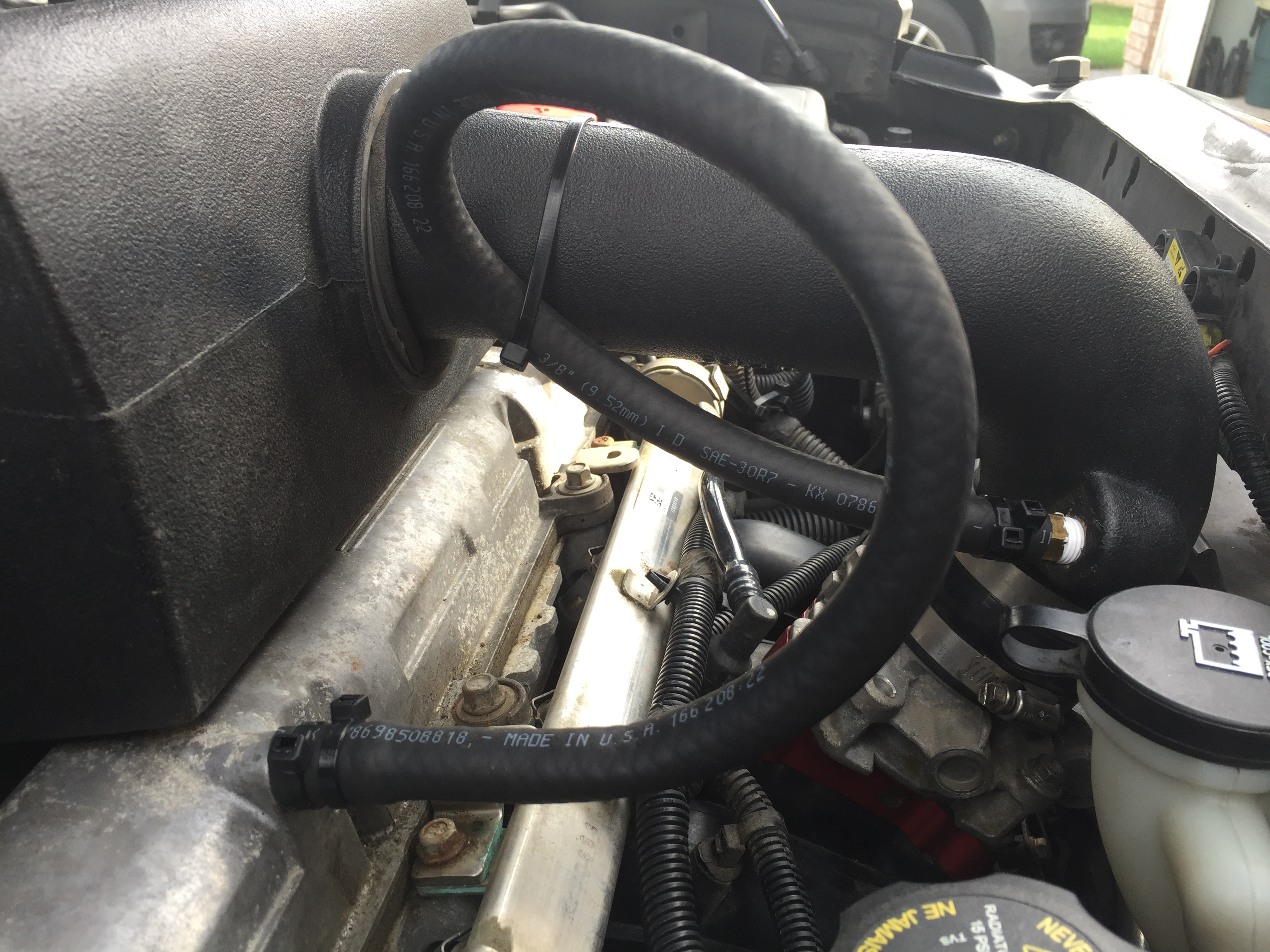

For my oil issue I made gravity work against the oil and vacuum of the intake. I cleaned out my throttle body and after 1,800 miles no more oil getting sucked into the elbow just before the TB, I used a 2 foot length of 3/8 ID fuel line, a squirt or WD-40 helped with slipping the hose on the tube sticking out of the valve cover.

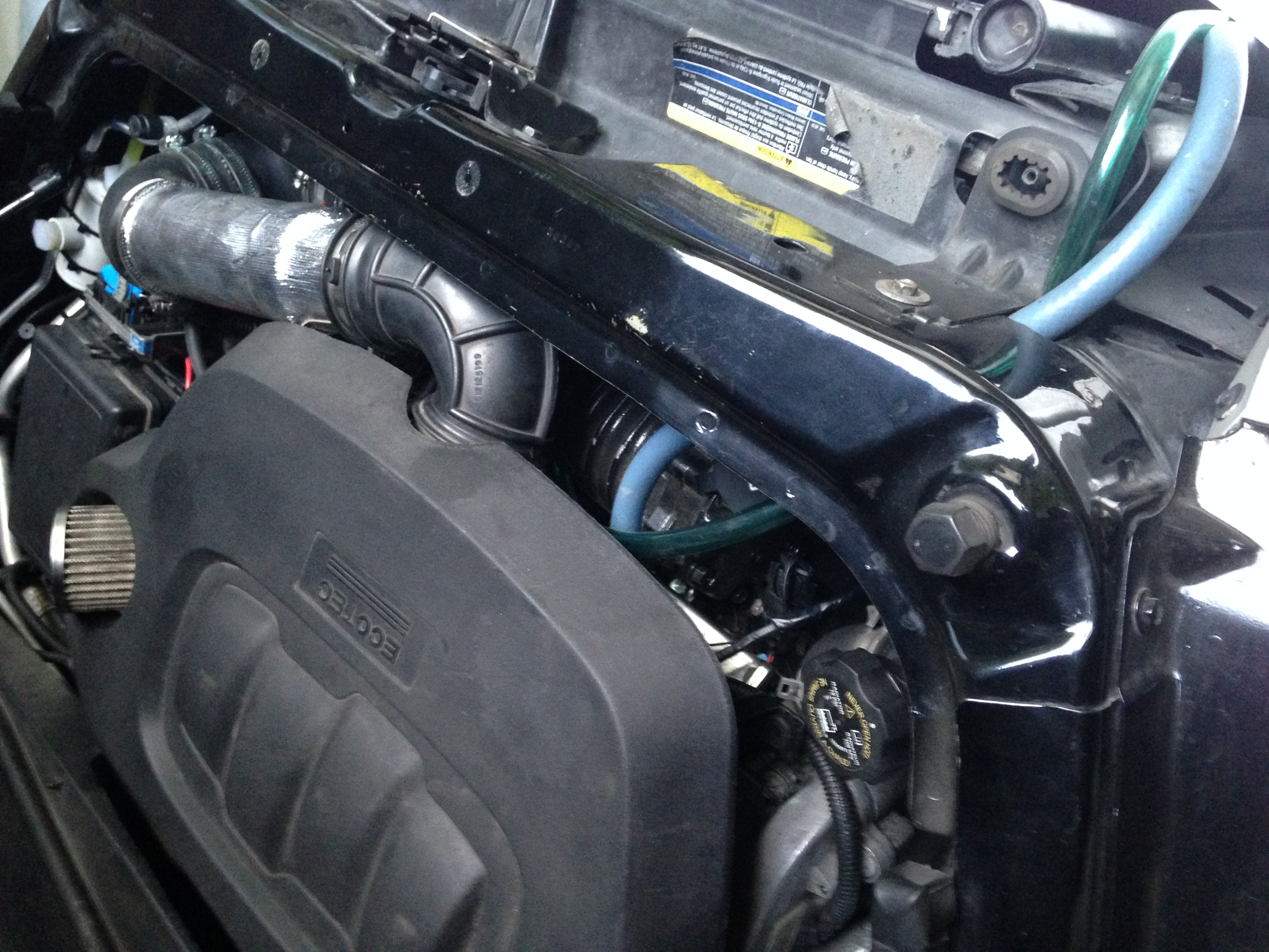

Some times the simple fix is the best.
I took the vent line off the valve cover ran it to a oil separator/catch can which resides behind the heat exchanger behind the bumper. Then it comes out of the separator and back up to the intake before the supercharger. As you can see I have a ZZperformance breather on the valve cover instead of the cap. Results well after 1500mile trip on the west coast on I-5 Average speed around 70. I had no oil in intake and drained out 2 oz of water/oil from oil separator. The water is condensed from the hot air coming out of the valve cover. When it gets in front of the radiator support the cold air on the tubing causes it to condense. It collects in the can. With 224K on this engine and it is supercharged with boost at 18psi. This isn't bad for a simple system.
Now I just have to work on my picture posting.

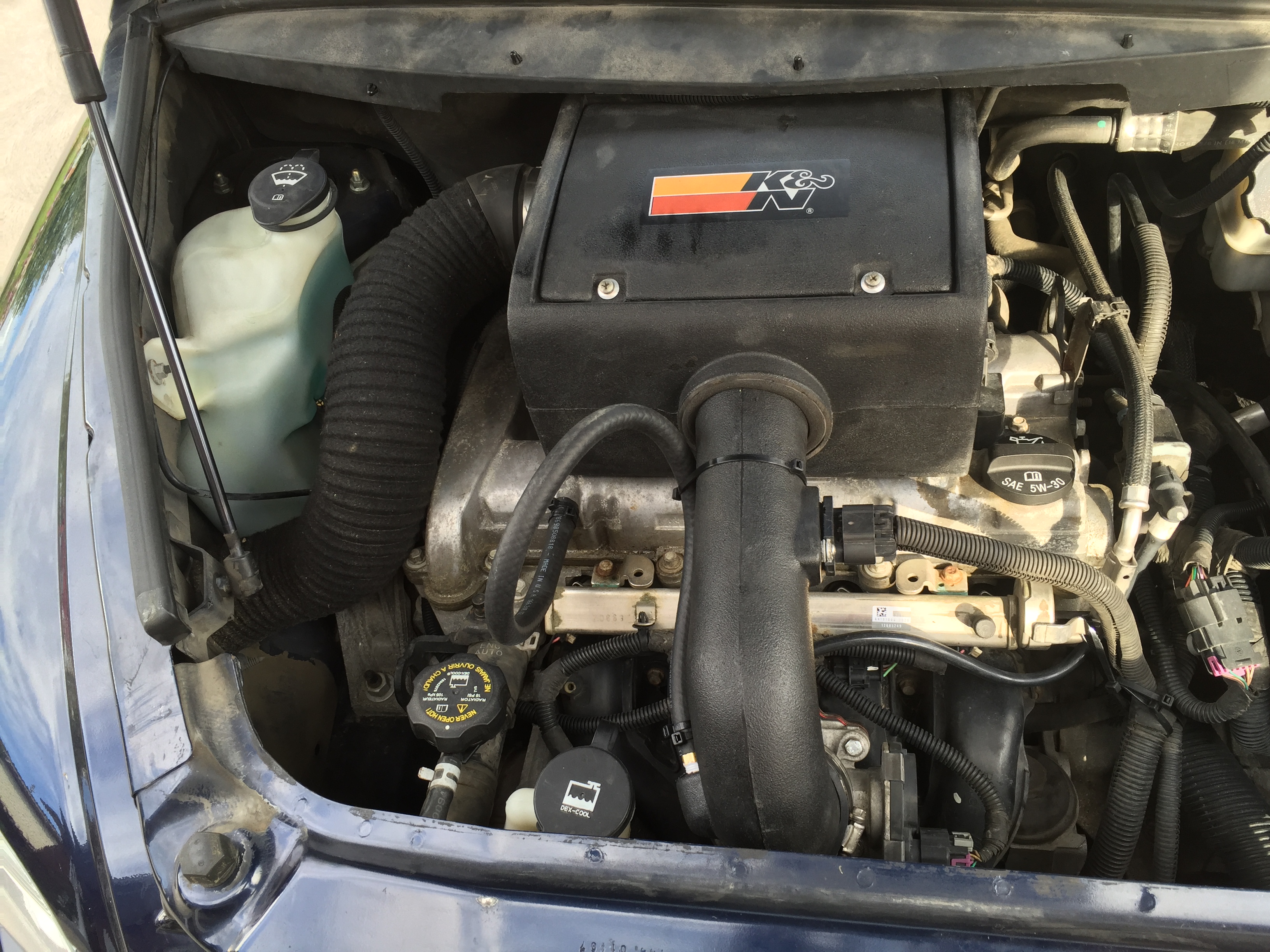

I experimented with my oil filler cap. I found a supplement bottle with a neck of the proper size to seal the cap & O-ring. Drilled and tapped and installed an air fitting into it.
I regulated the air pressure down to nothing, then adjusted the regulator so that just the slightest amount of air pressure was present. Holding the filler cap in place, it seemed like there was a small leak, but I couldn't tell where. I tried to somewhat simulate engine conditions by putting some water in the bottle. If I could get the water airbourne, maybe that would expose the leak. Well that didn't work. But then I turned the assembly upside down, and the water came pouring out, not past the O-ring, but from between the light and dark colored parts of the cap.
Aha!! This cap is vented. There must be a valve buried in there, seems like it's designed to let air in while crankcase is negative pressure, but not let air out while crankcase is positive pressure. I'm thinking mine is defective. I'm imagining a rubber flap that lets air in unless the crankcase pressure pushes the flap up and seals an orifice. When I turned it upside down, the water just flowed around the flap. But there is no rattle to it at all, so I don't know. I may tear the cap apart to see. If I do I'll start a new thread with pics.
So I got the 7031710 (only a few dollars) which is definitely a non-vented cap. So not as good for the crankcase breathing, but at least no vapors will be soiling the valve cover. As shown here, there are 2 caps for the HHR 2.0, 1 vented, 1 non-vented. Chevrolet HHR Hatchback ENGINE ASM-2.0L L4 PART 2 CYLINDER HEAD & RELATED PARTS
12583570 is the other GM part number, the non-vented.
Here is the cap that came on the car.
The description for the non-vented cap(in the above link) seems like it's saying my cap is non-vented. Maybe I'm reading too much into what the descriptions say or don't say.
