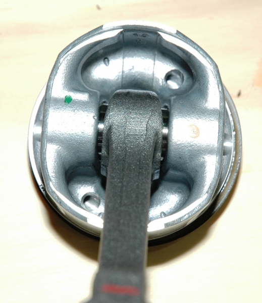

The LNF does not Have any sort of windage tray or scrapper. It does have oil squirters that sprays oil towards the bottom of the piston. It's directed toward holes that are drilled into a chamber of sorts. My guess is that during casting there is a cast in pocket below the dome, oil is sprayed at that hole/pocket to keep the piston head cooler.
That being said there is a lot of oil mist in the crankcase area, the oil shedding coatings will help prevent any oil from sticking to any surfaces that it is applied too. I.E. Rods, crank, lower crank cradle, oil pan....
