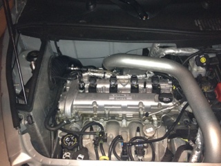

Will as you can see they do get quite Hot
CIA's upper pipe is one piece, unlike Hahn, ZZP & a few other that are two pieces, for an intercooler, Hahns or ZZP are excellent choices.

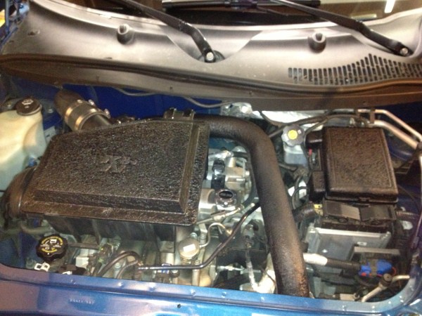

One piece upper charge pipe FTW! Less couplers=less problems and promotes less turbulence.
