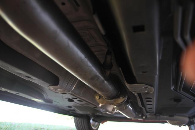

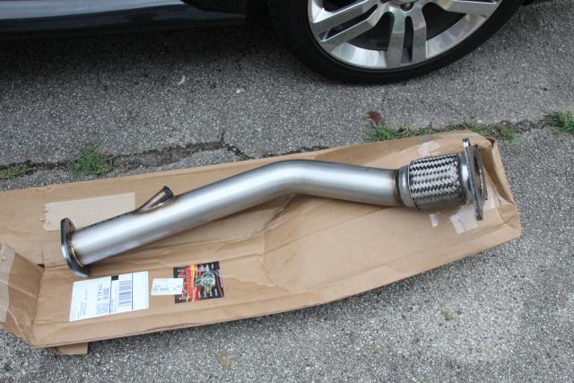

Put the DP on, tucked the tip, just a bit more. as you can see gotta bend the heat sheild a little for the O2. No codes the built in de-fouler works like a charm. if it does throw codes it will be three of them. P2195, P0161, and I forget the third. easy to clear though. If it happens I've got it reader/clearer. which is a must if you have remote start. with a CEL, it won't work. Btw, my gutted stocker, has nothing on this baby.

That looks really good Foolmoon, I'm thinking of getting one and updating my tune. We'll see.
