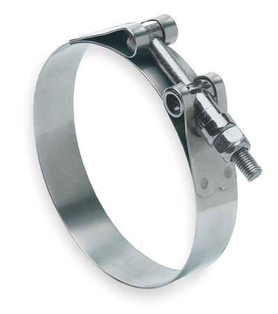

Originally Posted by KissMy08SS
what are those? not sure I've ever used them before...
Hear ya go! This is a T-bolt clamp.

ATLsilverSS's Avatar
Joined: 04-03-2009
Posts: 707
From: atlanta, ga
^^^^^this versus the standard worm drive clamps that are commonly used....like the one that connects the airbox and the intake pipe. you just can't get the torque and clamping force out of the worm drive clamps that is necessary for holding the pipes at high boost pressures.

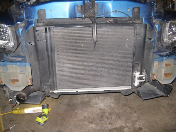

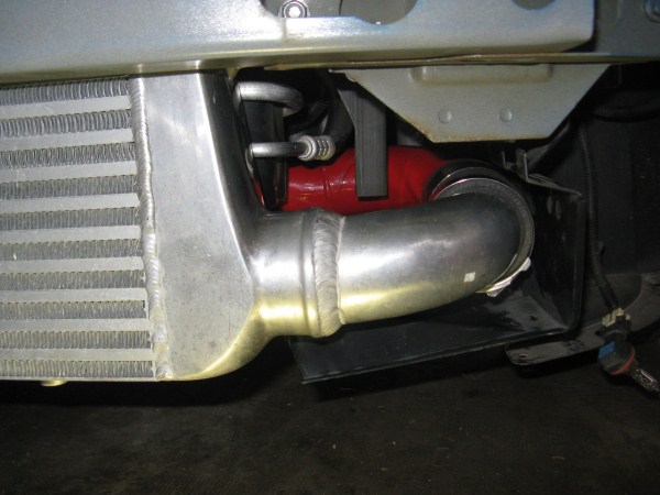

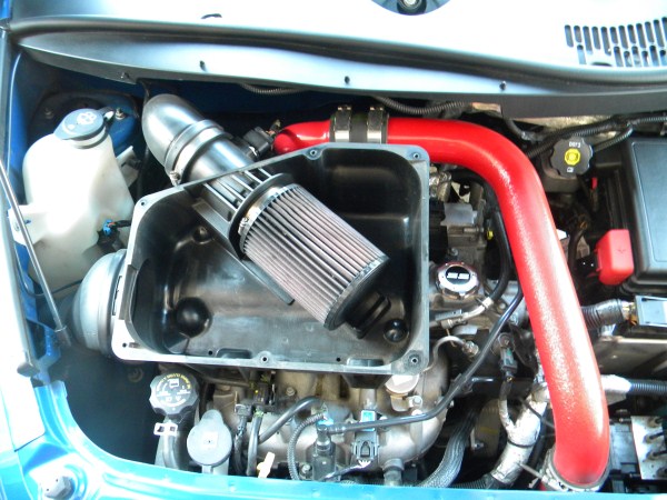

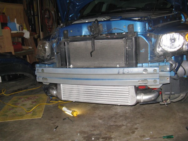

The sabb needs a little adjustment to the mounts that hold the aircondtioning requires large pair if needle nose. Here is the Readers Digest version. If I can do it it's not too tough.
