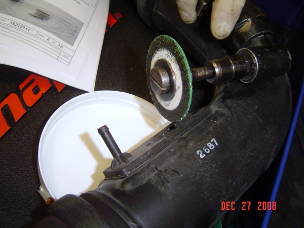

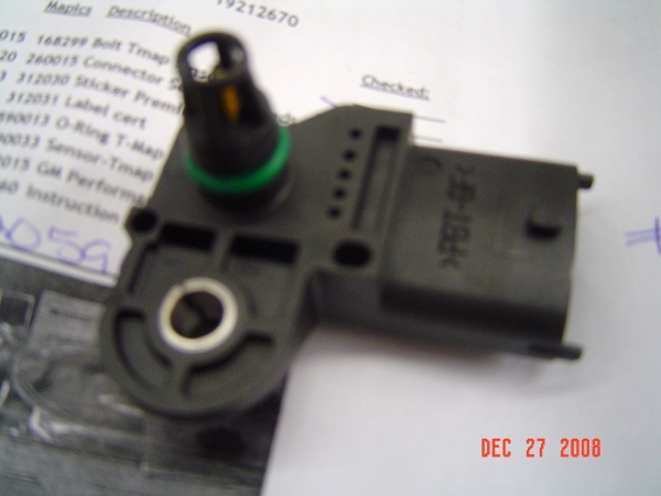

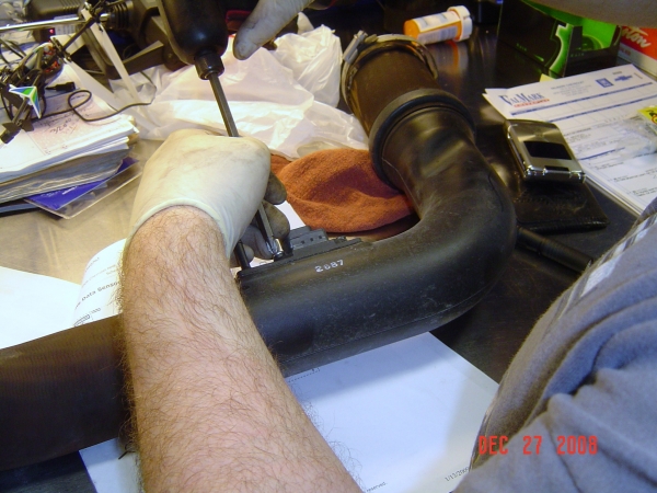

I read something about modding a sensor to make it fit correctly?
Old Jan 17, 2009 | 11:39 PM
ivtech's Avatar
Joined: 01-14-2006
Posts: 1,615
From: La Crescenta, CA
The boss on the sensor that goes on the charge tube has to be cut/dremeled off.
Old Jan 18, 2009 | 06:25 AM
gcsd3742's Avatar
Joined: 11-07-2007
Posts: 1,613
From: Southside of Houston Texas
Cut-off but not the boss:
Here's the pics I took while my install was being done.

Originally Posted by mistermike
Would one of your gentlemen be so kind as to refresh my memory on the post regarding the O ring lube deal. It looks like I'm going to have to pop my dealer's cherry on this kit install. I'm hoping the lube won't be needed when it's time to pay the bill.
You have to remove the green orings from the sensors and install the supplied blue orings, which need LUBE to get on the sensors.

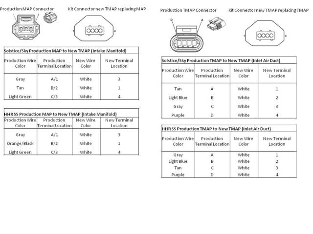

Old Jan 23, 2009 | 12:17 PM
More_Torque_More_HP's Avatar
Joined: 12-09-2008
Posts: 224
From: Detroit Area
Wiring charts
Thanks! I have a date monday at the dealer.
Take this with you, it will help clearify the HHR SS wiring because the wire colors are different than the instructions. Pinout is the same just colors are different.
