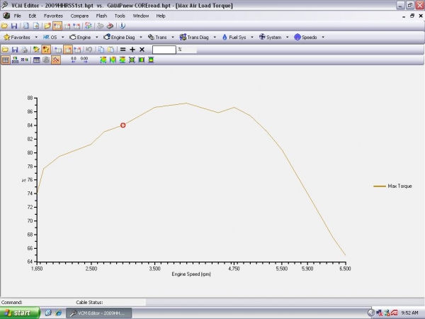

This torque curve shows why the GM tune falls off on the top:
It's a way better torque curve, than stock, but still drops off
like a rock, the same as the stock curve, after 5,500rpm:
This is my torque curve, using HPTuner software:
This is the stock HHR SS torque curve:
This is why the HPTuner software is the best...
