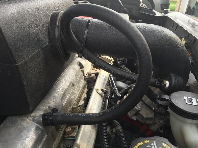

Welcome to the site! Check to see if oil is being sucked from the hose from the valve cover to the throttle body.

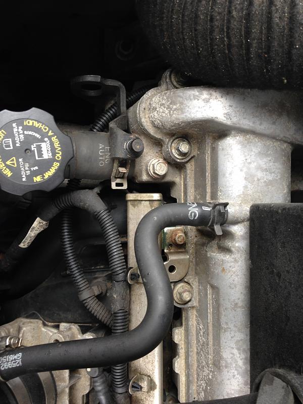

Mine was ingesting oil through this hose, I simply replaced the hose and made a loop using 2 feet of 3/8 ID fuel hose. This may look different from your engine as we have different air filter housings

I believe the 2.4 has the same hose as the 2.2, simply disconnecting the hose at the throttle body end wil tell the tale, of oil getting into the intake elbow!
