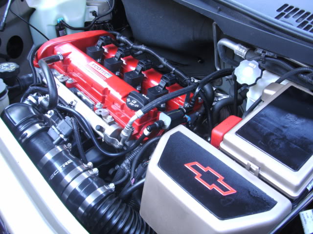

Yep the 2.2 is sensitive to the MAF tube size,too large and the car runs terrible.I used the tube off of my stock airbox too. Name:  001-16.jpg
