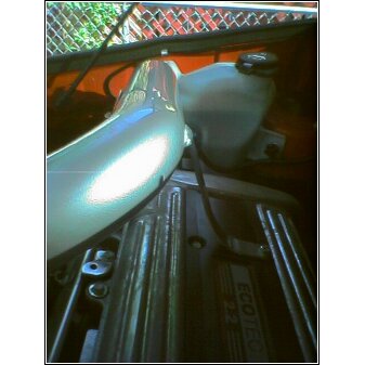

Front View of Installed CGS

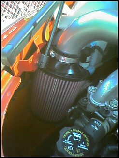

CGS Filter Placement
Side View Showing Modified Support Bar
