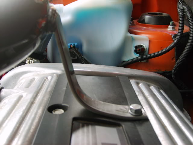

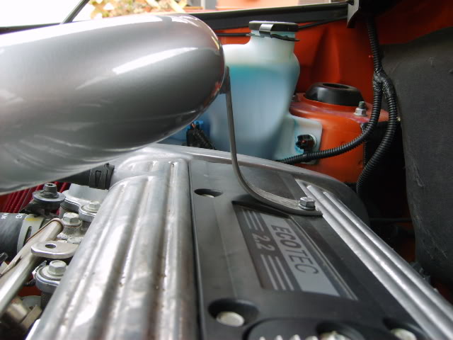

For those of you who read my original instructions...they worked great. Due to this being made for the 2.4L, mine was still rubbing against the hood strutsm making noise and damaging the paint on both the struts and the CGS. Below are some photos and additional instructions so you won't have to go through what I did when I did mine.
The modified length of the CGS support arm on mine now is around 5 1/4" from the top weld to the tip end by where the bolt goes into the head. I measured down approximately 2 1/4" from the top and put a new bend in the arm as you will see in the photos below. Then once I was happy with that bend, I marked it so I could cut off the part that overlapped over the head and cut that off with a hacksaw. I then marked where the new bolt hole had to be drilled a new hole for that.
I didn't have a vice to bend it with, so I pulled out my boyfriends hydraulic jack and put the arm in between the metal pieces and carefully bent it where I had marked it. Crude...yes, but effective.
Here's the photos I just took so you can get an idea of what it looks like. Hope this helps the 2.2L owners. Not professionally done, but a girl has got to do what a girl has to do. Another mod done by little ole me.

Well I got my new cgs intake installed, Installation was easy with courthousedeb's post above. Thanks courthousedeb, I also got me a imco t-924 turbo muffler put on my hhr.
