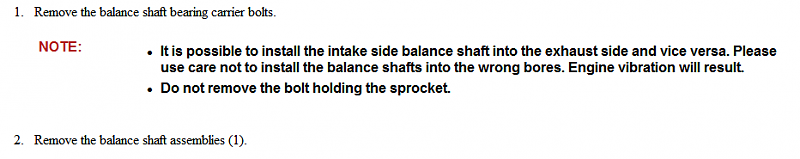

I can't see the broken bit. Most don't bother replacing the balance chain sprockets.
Those are not the cam shaft sprockets! The book says not to remove the sprocket bolts, the shaft and sprocket is an assembly.
The other chain is the camshaft chain.

You're saying that the intake broke, but the sprocket pictured clearly says "exhaust". Like donbrew posted from the repair manual, make sure you haven't swapped their positions, intake and exhaust.
I just used a pic off the web as an example...I busted the entire corner off, so nothing is securing the shaft. Will head to the dealership monday. Thanks again guys!!!
