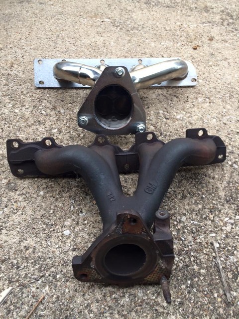

yes, both the felpro and the gaske that came with the header are blowing out. the flanges are the same size and Ive made sure they are flush. but Im wondering if it warps when it gets to operating temp. the inside diameter is a bit bigger on the collector of the header than the opening of the cat. I havent tried the stock style with the metal ring in the middle... I have a pic here that shows the difference between the stock manifold and the header. It keeps blowing out the bottom of the gasket. Im pretty sure that they are true. I filed them down, spraying guide coats to make sure they were flush. the only way to really make sure is to take them to a machine shop, but like i said. it may warp a bit when they heat up. wondering if I should file it when its hot...

Well! the new header has an oval hole, the old downpipe has a round hole. Do you think a gasket with a round hole would work? Did you put the gasket up against BOTH pieces for fit?
I would try one of the "generic" gaskets that are much larger than the flanges, but fit the bolt holes and the center hole.
The other possibility is that the bolts/nuts are not fully engaging and pulling the parts tight. I had that problem with an after market downpipe that had a thinner flange plate; they could not be tightened any further, but they were not tight enough. Washers fixed it.

Im skeptical that the stock one will fit right. I think it will blow out past the metal ring.. Ive cranked down the bolts pretty tight, and they have tons of thread left. It wont hurt to try some washers. I can get this gasket replaced under warranty and drop the $1 for the washers LOL

Those stock gaskets will not fit the header, I can see that from here. The hole in the header is oval, there is not enough metal around it for the two pipes to seal on the gasket. One with a ring won't help because it needs contact on both sides.
