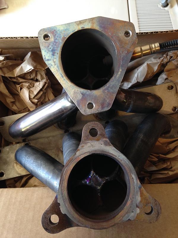

I have tried many headers on my car and found out some are good and bad. What you are finding out is a out of round problem on the collector flange. Here is a pic of two headers from two manufacturers. You can guess which one leaked. If the hole is not round and inside of he gasket it wont seal.
I had to weld the hole on the collector flange and re machine it to work. It is a back up now.
