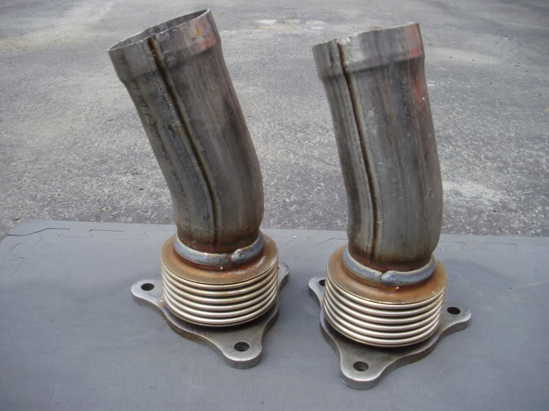

Does it look like these would fit? Hes asking $45 each. Designed for cobalt ss/sc.

Well I was looking for a bolt in replacement. At most I would be up for welding in a flange but seeing how that is just the initial dp section there would be a bit for fab.
If it was my personal car I'd be in for it but this is a company car that is leaving soon..
