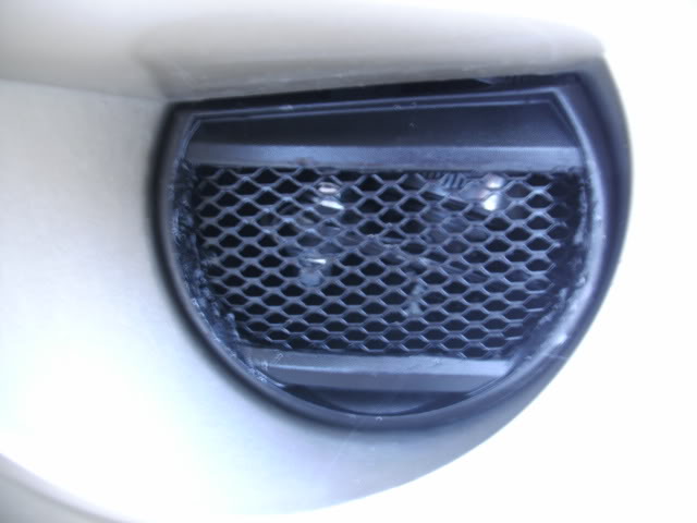

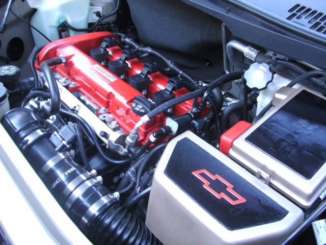

Simuliar to my setup,except mine runs to the other side.I also cut my MAF tube off the stock box(wasn't an easy cut,had to cut flush with the box)Mounted my cone filter up inside the fender well behind the headlight on a bracket I built.Then cut the foglight cover out to get more airflow.When I had the bumper cover off to install my depos,I figured out how to run the intake in aluminum tube(another project) The only drawback to the filter being in the fenderwell,is to clean or change it.You have to remove the wheel and pull back the inner fender.Other than that,it's a great cold air system.
