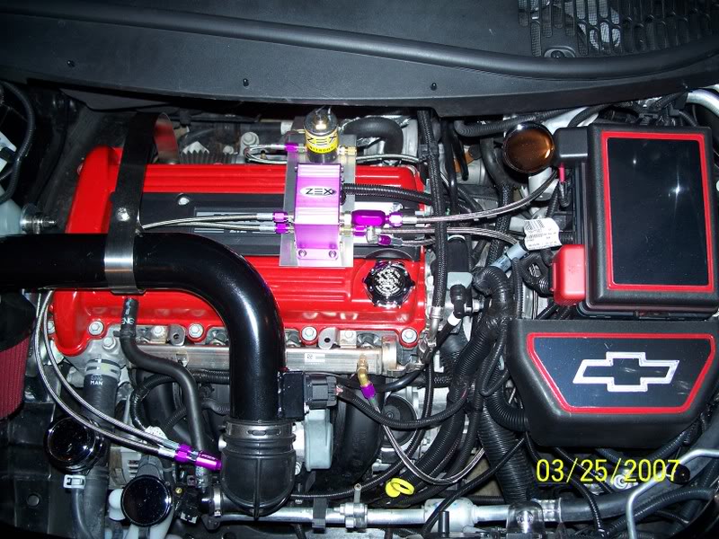

i just ordered my zex nitrous kit for my 07 hhr

Along with your Zex kit I would recommend a "window" switch from someplace like MSD. Just in case you are unsure or for those reading that don't know. The window switch is programmable to make sure the nitrous does NOT activate too low and to shut it off before the rev limiter to prevent nasty engine destroying results. A good start with this switch is to start the acivation at 3500rpms and have the cutoff around 6150-6200 about 300 rpms short of redline. This would save your engine more than you know!

RUDEINC's setup:
