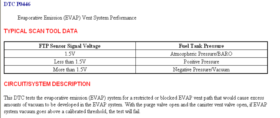

​​​​​​Test failed with the FTP showing -7 inches of H20 and 2.8v
Test Result: Excess PressureIf all the lines are not obstructed and the charcoal canister is in good condition, not contaminated, not plugged, is this a physical issue or electrical?

The test relies on the vent being OPEN. It is "Normally Closed". And the purge being CLOSED. It is "Normally Open".
I don't know what you expect a wiring diagram to tell you. There are 2 wires, one goes to the fuse box the other goes to the ECM. The ECM controls the ground signal.

The FIRST thing is the capt. However, there should be a message on the DIC like "check gas cap".
Since the P0446 test specifically checks for "restricted or blocked EVAP vent path", probably a good idea to look there.
