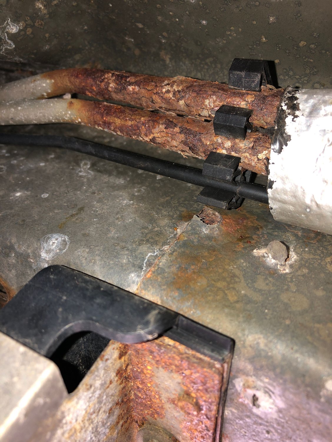

The fuel lines on our trucklets are getting on and are rusting out . Here’s where to look , for said corrosion
Here at the front under the drivers side at the front clip
A little farther back , no fuel yet be rust at the clip
Here just in front of the drivers side rear tire where the insulation starts
And here where the lines go across to the passengers side up above the EVAP canister.

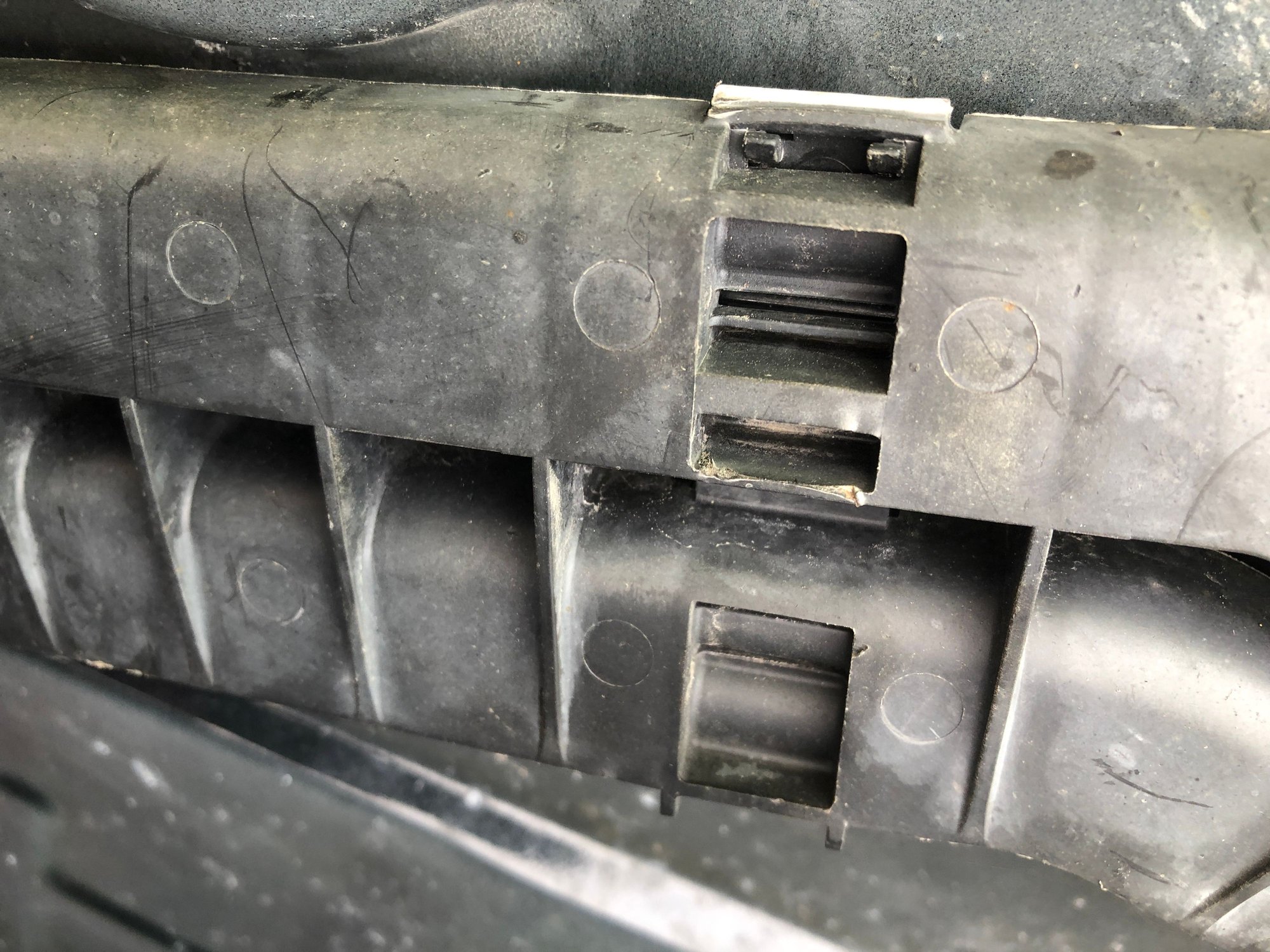

The clip opening has been addressed before in this thread, thanks Kookie
https://www.chevyhhr.net/forums/prob...y-clips-60557/

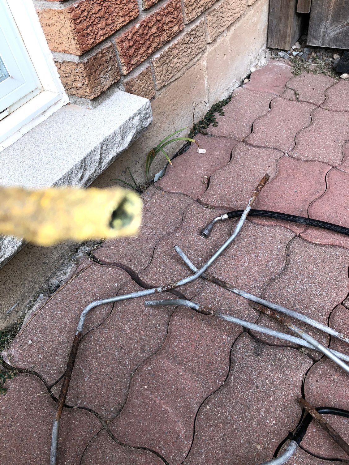

After removing the insulation I found the vapour line was perforated with rust
The line crumbled , this was under the insulation

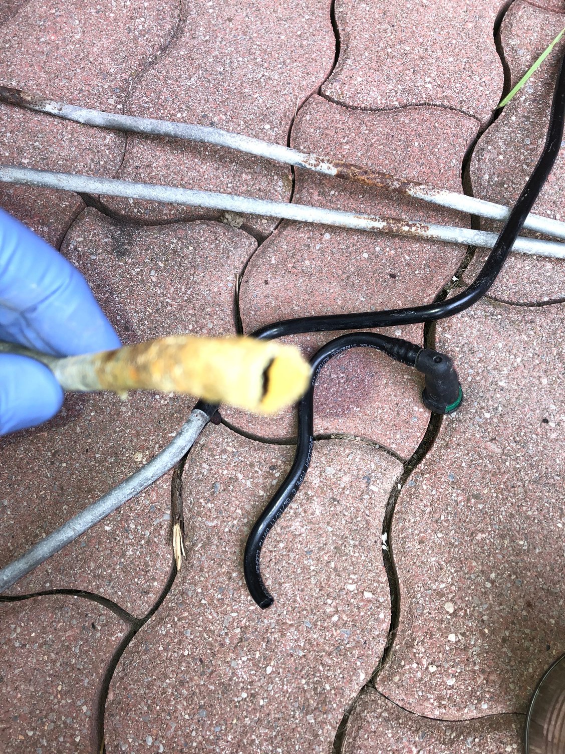

This was the fuel line just as rusted but not fully through just a pin hole , noted the drip on Saturday night.

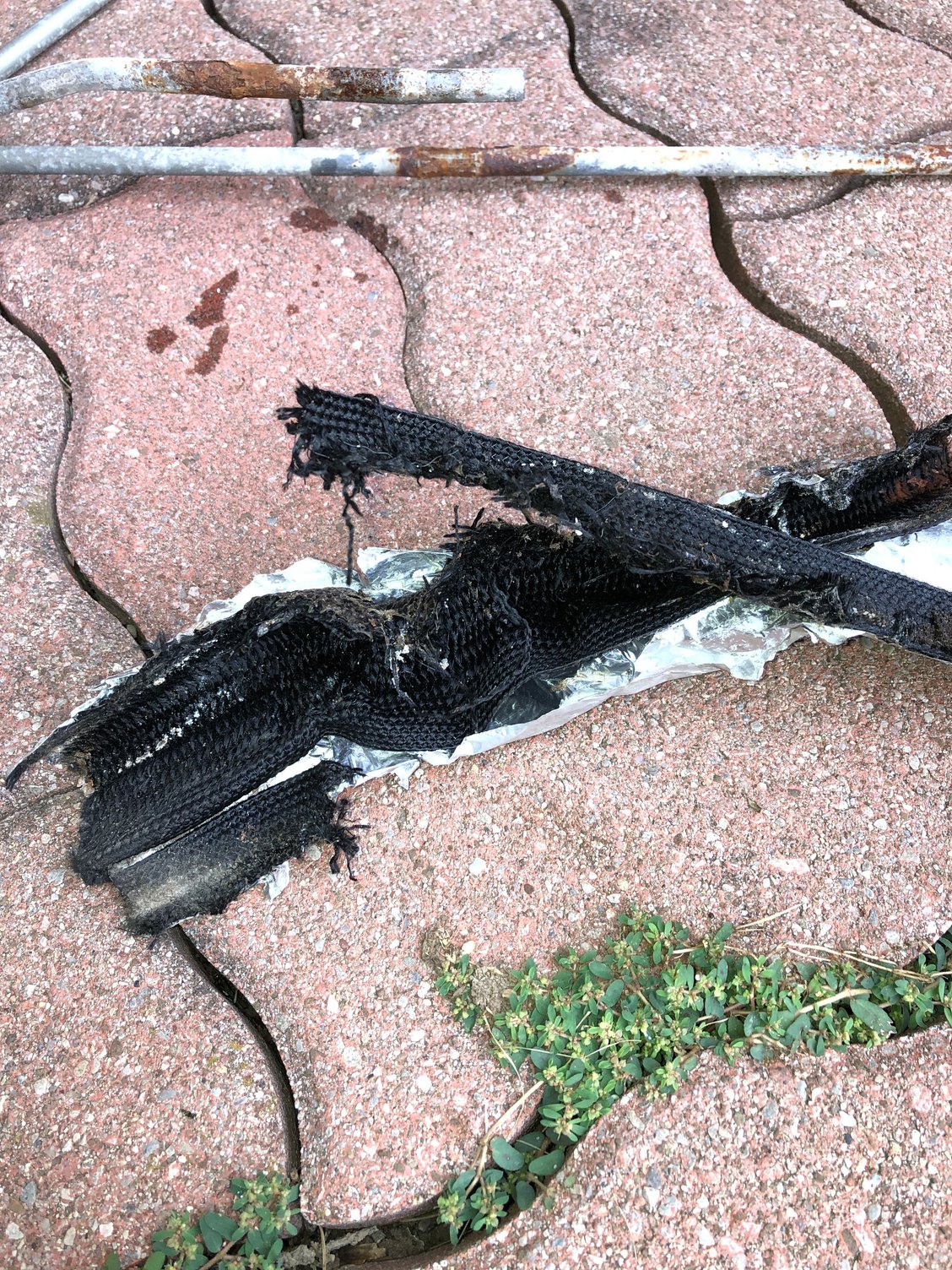

This is the fuel soaked insulation, it held moist up in there most likely from condensation

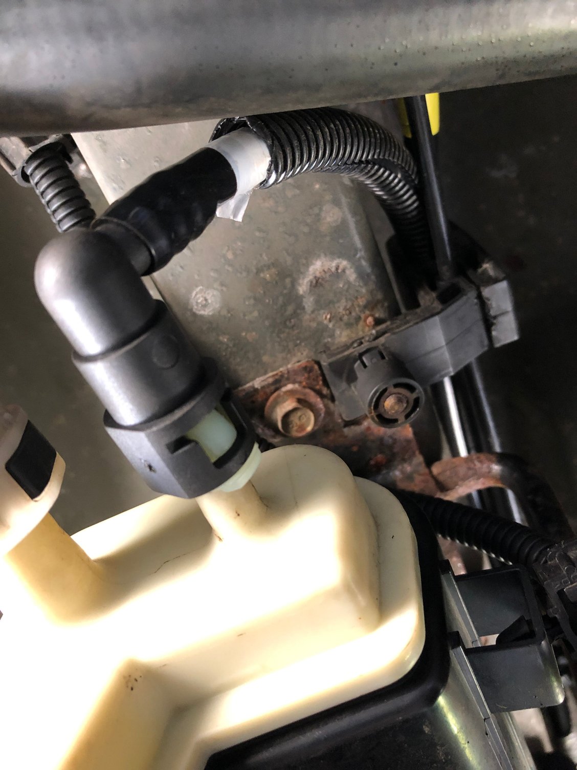

This is the EVAP canister end of the vapour line , you simply squeeze the flat area and the rounded area gently together with pliers and remove from the plastic tube it’s attached to

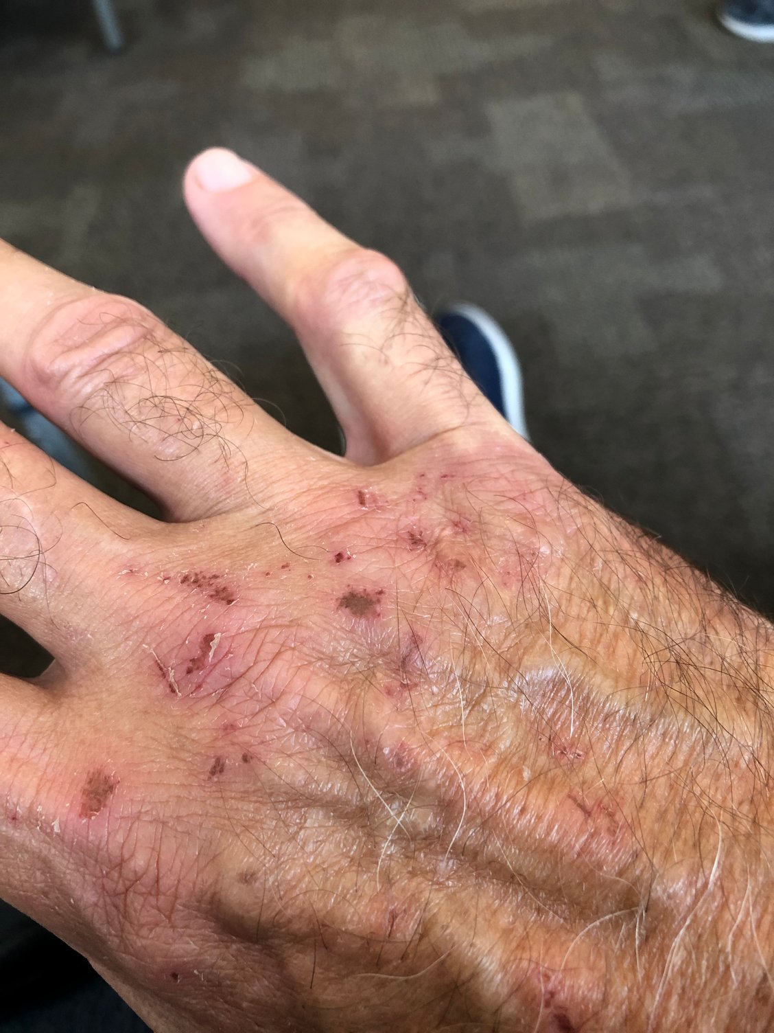

Up under the back after installing all the clips to support the nylon tubes, I connected the fuel pressure line and the vapour line, and tie wrapped the now dried in the sun insulation above the exhaust pipe. I strongly suggest you wear mechanics gloves , I didn’t, but in hind sight , a couple of bucks at HF , and even if they get soaked in fuel and throw them away. It’s better the scratches and abrasions on my hands.

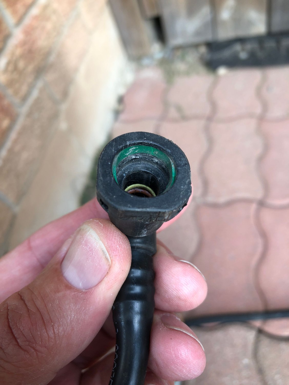

Here’s the connection for the vapour line to the EVAP canister
This is the pressure line connection to the pipe that goes over the fuel tank to the fuel pump.
