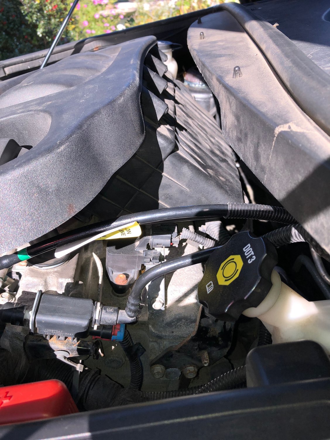

This vapour line connection looked ugly and leaked air, so I went to local pick a part and cut the line way down by the steel line , lotsa tubing to have to measure better
This is the new to me tube and fitting from a sadly wrecked HHR.
The connection union is fully engaged and seated and not under any stress from the tube bending an inch or two from the EVAP valve. The P0455 code is no longer popping up since I did this , last Friday.
