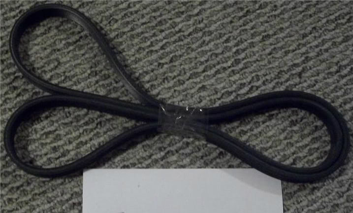

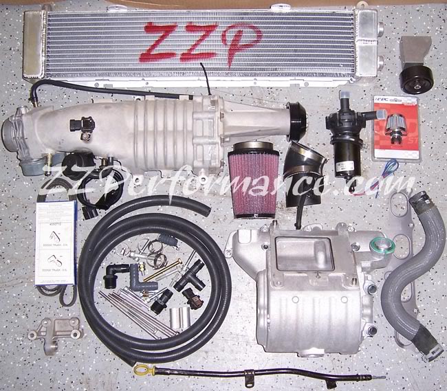

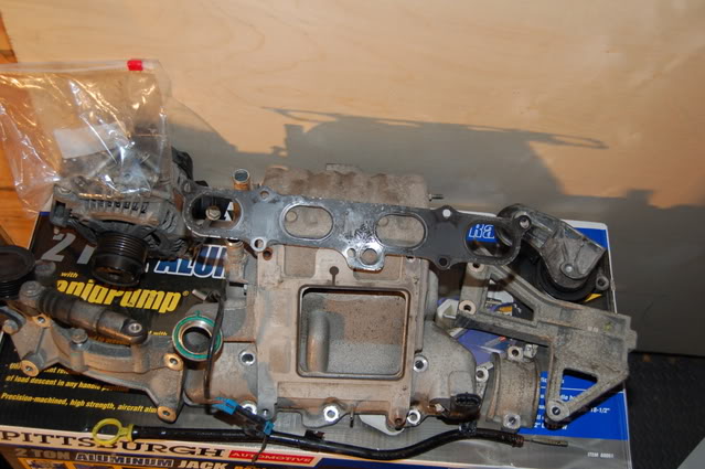

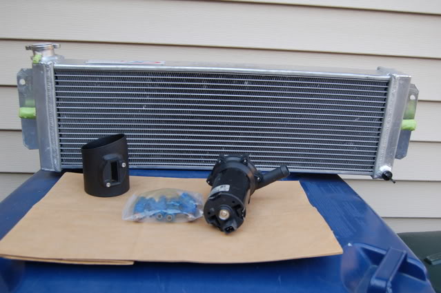

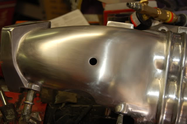

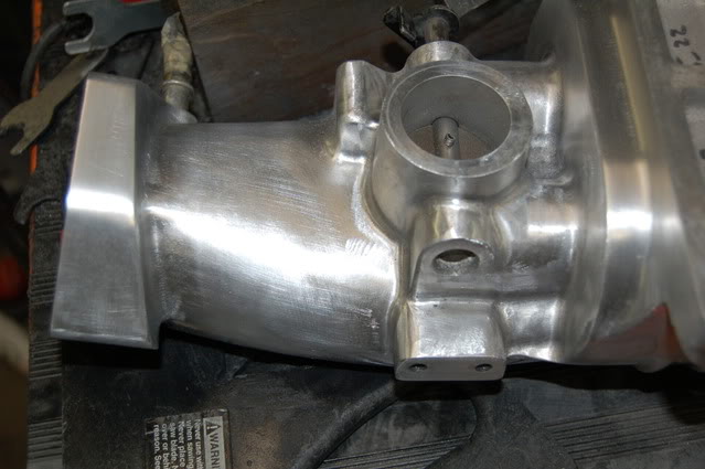

Check that M62 out, they were made/setup for Different cars, that don't look like the Cobalt one to me. It's gotta bolt to the intake manifold that fit our engines. You'll need that intake as well to bolt the supercharger on. I just noticed, it says > "Make GMC"
ZZP sells a "kit" but piecing one together yourself can save you several hundred over buying the Kit.
But you gotta find the used or new parts to save. I just bought used parts as I found them. I'm in no real hurry to install mine, just putting my kit together and Polishing the supercharger and other parts. When I get to it, I get to it.
You'll need to get 2 gauges as well. one is about $200.00 for it, the other is only 50-60.00.
A Tune, I am planning on getting the HPTune software Pro set.

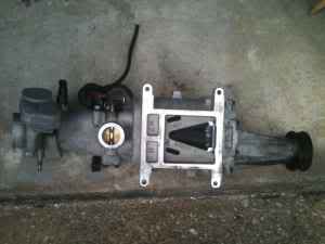

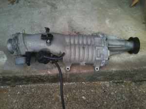

This is the Cobalt/Saturn M62.

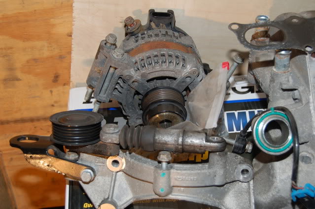

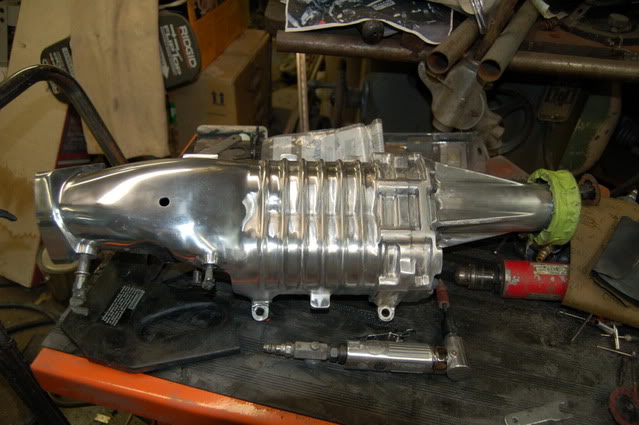

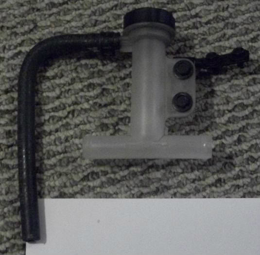

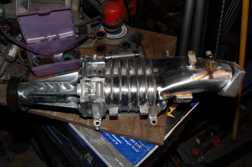

Just make sure the one your looking at is the right one , I have no idea if other M62 configurations will work, or if that one IS a M62 or not.
Or the Kit.
