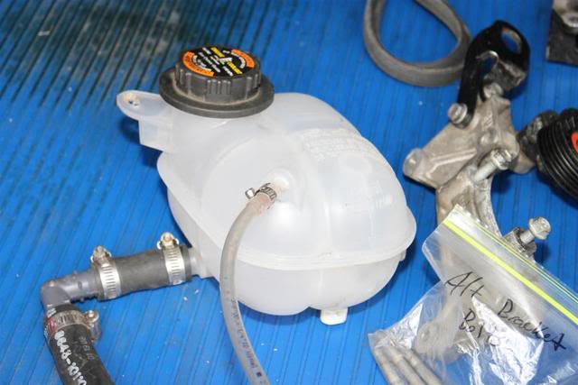

There is, this is hhrfreeks and you can see it. His was a 5 speed.
And this is the stock SS/SC intercooler filler neck and bracket, bolts right to the M-62 Supercharger.
So you can fill your intercooler setup right up top.
If you go with the "Option B" setup you add another small tank like this and it adds more coolant to the system. More coolant, cooler temps.

Yeah but auto like mine has less room up front, may not work that way. Id love dual pass and option b, not sure if the tank will fit though. Its a pain to bleed the system with the little filler neck. Did he have it on his hhr?
It will all need trial fitting, which is why I havent had the block of time I need.

Have a look here, this HHR Auto Trans was just recently done.
He Moved the filler neck that usually bolts to the supercharger.
I am also running a auto trans.

thanks, a few new details in there. Looks like he did relocate the coolant tank to the passenger side. And cutting the engine casting to clear tensioner pulley is something I didnt see before.
