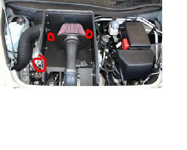

you will have to see if the mount points are in the same location... you can also try the K&N kit also, they say it doesnt fit 2.2 but it does..up to you.
If i remember correctly, there are 3 rubber grommets that snap the housing into place

[IMG][/IMG] This is on an 07 2.2 automatic. A little adjustment on the 2 front mounting screws, works great for the past 4 + years.
