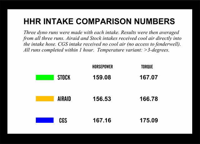

ive been doing a little research on which CAI to purchase and i believe with this PROOF chefhhr is right. sometimes they do make enough of a differnce you can feel. especially if you know about how long it should take to get to say 60mph etc. and an 8hp/8tq gain id imagine you could notice a difference, this is what ive found.
