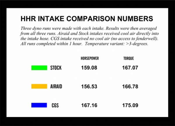

Originally Posted by jay loukakis
check the socal hhr website they tested 4 diffrent mfgs. airraid had a HP loss
That faked chart was more than just clueless and biased, for anyone who knows how HP and TQ are computed, those FAKE numbers are downright IMPOSSIBLE!!!
Referring to this:
I've said it before and I'll say it again....
Knowing the the OEM intake is NOT restrictive, any other choice had better be a matter of desired appearance or sound. Do not expect any gains in either HP or MPG.

You saying a stock 2.4 auto can't put down 159HP on a dyno?
Nope!! A "good one" may, but normally about 145 WHP, but....
Keep in mind, we are talking about crankshaft HP and TQ, vs. "to the wheels (dyno)" numbers....
For some reason, GM rates the 2.4 at 165 TQ (engine dyno), yet this "fake chart" shows 167 to the wheels. Given the drivetrain losses, that number is physically impossible!!, unless someone has a "miracle" engine. With a FWD car, expect about a 10 - 15% loss to the wheels.
Horsepower is nothing more than a calculation of torque vs. RPM, even on a dyno. Here is the SAE formula:
HP = TQ * RPM / 5252
Play with this fake chart and the SAE calculation formula and see what ya'll come up with!!
I've done the "math" on this (hey, I'm a SAE engineer!) and know, without a doubt, that that chart is FAKE or, at least, based upon inaccurate data.

Anyone should notice that those numbers are skewed.
#1 being that our 4-bangers do not make more torque than HP.

Originally Posted by JoeR
Referring to this:
Hmm... Temperature variant greater than 3 degrees
