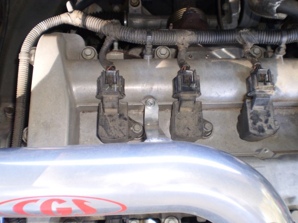

Hey all... quick question.
I am really leaning towards the CGS intake, just to clean the crap off the top of the engine. The whole airbox-up-top thing just confuses me... why make basic maintenance like changing the spark plugs such a PITA?
However, I am curious as to where the CGS intake mounts. From the pics I've seen of it installed it looks like it bolts to the valve cover or to one of the coil packs? I hope I'm wrong there.
Exactly how durable is that mounting point? I am concerned about bumps and vibrations working something loose or wearing it out over time.

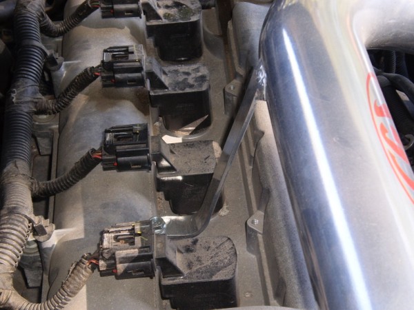

It bolts directley to the Valve Cover ! We used a small amount of locktite and so far after a Year and 12,000 miles no problems to this point , knock on wood !

It bolts directley to the Valve Cover! It does not utilize the bolt that holds the Valve Cover to the Head! Should be "NO" issues keeping it secure !

Here's a couple more pics to better show exactly how the intake mounts

30k on my CGS intake. I have had the bolt come loose a couple of times. This happens because the intake vibrates when the engine is running. When I'm at idle it vibrates against the the windshield fluid bottle and make a noise you can hear.
I have been able to stop both of these problems. I put a little blue Locktite on the bolt and wedging a block of foam between the intake and the fluid bottle. The foam reduces the vibration buy reducing the intakes movement.
