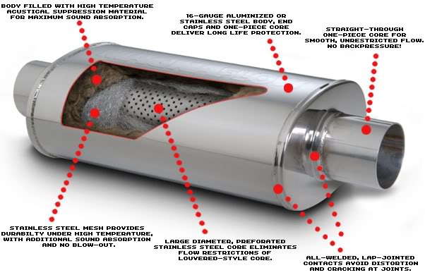

In my opinion, you should have had a custom exhaust made. It would have been cheaper and you can pick your own muffler and tip. The Magnaflow catback is made to install yourself, like you found out too late, but it's overpriced. I recently had dual exhaust put on mine, with SS mufflers and tips, for about the same price as the Magnaflow system. Single exit would be much cheaper of course.
I could be wrong, but I don't think there will be any break-in with Magnaflow mufflers. They use stainless steel mesh instead of fiberglass. I haven't noticed a difference with mine yet anyway.
