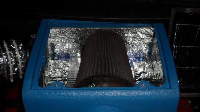

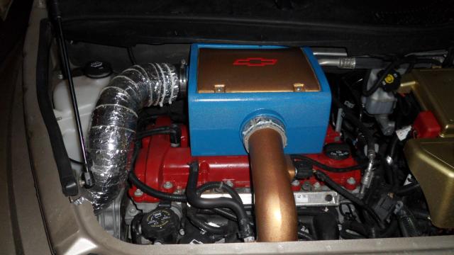

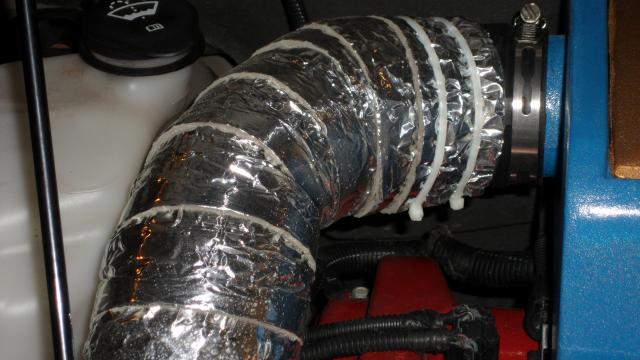

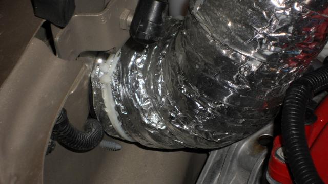

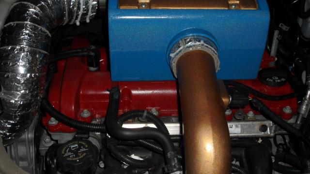

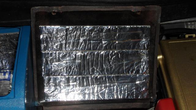

I have had the K&N box for over a year now, and I've had good results. One thing I did do was to insulate both the "wooly worm" AND the inside of the box. I bought some foam-backed foil plumbing insulation (about 1.5 " in width) from Lowes. It cost around $3 /roll. You can click on my gallery to see a good pic of the "wooly". I have a ScanGauge plugged into the OBDII, and I've noticed that there is only about a 4-8 degree difference max between the intake air temp and the outside air temp.The pics also are a testament to what an old guy can dream up in his garage on cold fall/winter weekends. (note the painted parts under the hood)I also installed a K&N "Typhoon" intake on my son's 08 Cobalt. It is a great deal noisier, but it being a 2.2L, it has more response than my 2.4L.

I think painting the tube and box with some Dupli color ceramic engine enamel would pretty much eliminate any kind of heat transfer. The K&N is a well designed piece to begin with though , I wouldn't really expect any gains but it would look nice :thumbup

A couple more pics of my K&N set up.
Here are a couple more pics of the K&N box and insulation.
