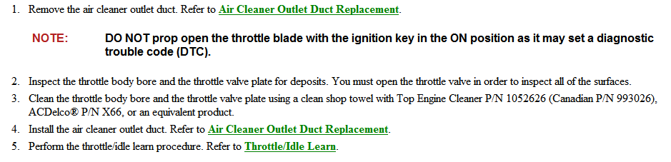

From the Service Manual:
2.2L/2.4L
2.0L
Old Jan 15, 2018 | 11:33 AM

Only 2.0L says to remove it.
I doubt that is your problem, more likely trans shifting.
