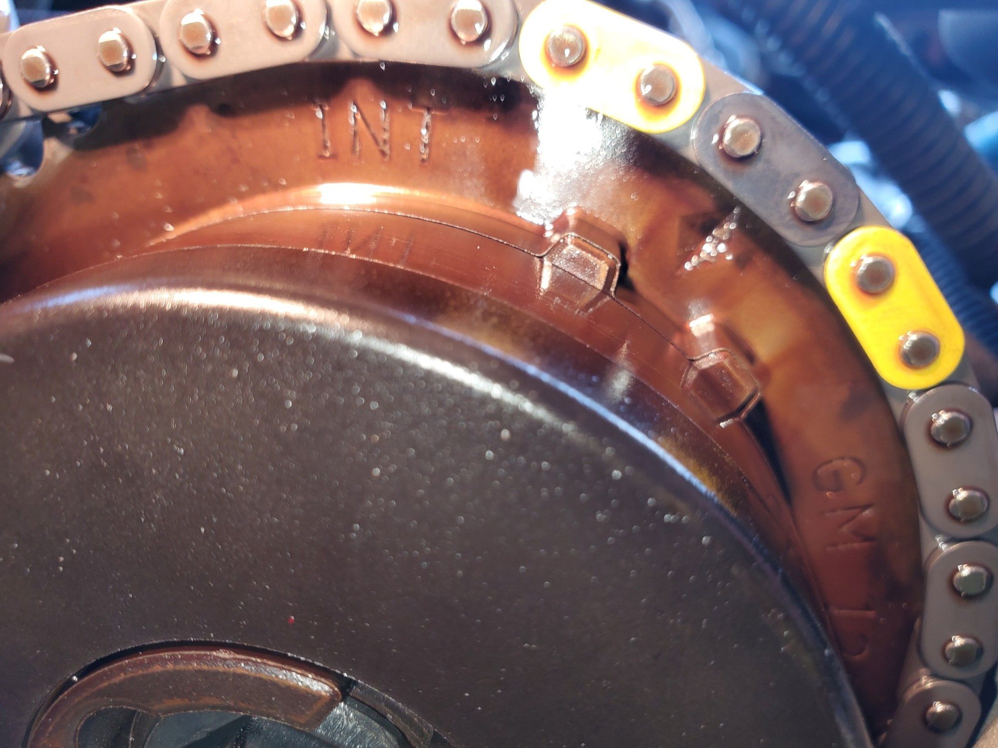

Old Oct 17, 2020 | 03:04 PM
Ohboy...'s Avatar
Joined: 10-15-2020
Posts: 5
From: Sarasota FL
Originally Posted by Oldblue
You will definitely have to replace the timing chain! The sensors are telling you it’s loose with that P0014 and P0017.
This was my timing chain on my 2011 2.4 code P0014. As Mrs. Doubtfire suggested, Don’t Fuss with it!
Like this?
And sorry, yes it was an LT, sorry,
Old Oct 17, 2020 | 03:11 PM
Posts: 26,540
Are you showing that the intake is a link off?
Old Oct 17, 2020 | 03:32 PM
Ohboy...'s Avatar
Joined: 10-15-2020
Posts: 5
From: Sarasota FL
Oh. Give me a bit. Thank you. I didn't even realize that
Old Oct 17, 2020 | 03:55 PM
RJ_RS_SS_350's Avatar
Joined: 05-01-2014
Posts: 8,512
From: California
I don't see that it's a link off, and it seems to be tight...

Old Oct 17, 2020 | 05:00 PM
Posts: 26,540
I guess it's the lighting. Maybe there are 2 yellow links.
