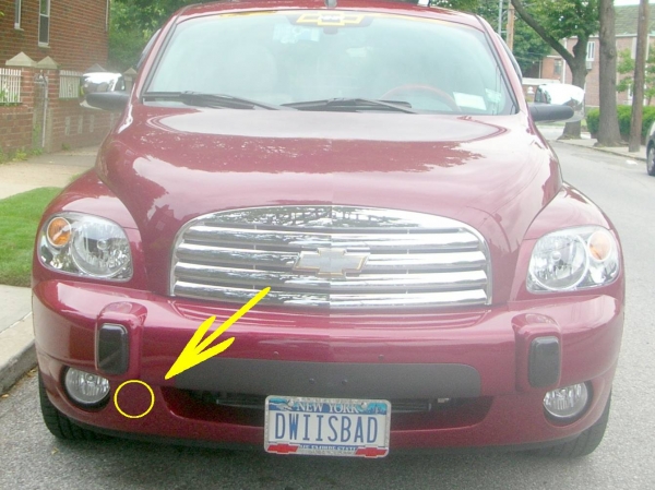

I was looking over the way CJ did his cold air hose, and realized that if anyone has the guts, the way to go for a true cold air/ram air set up would be to cut a 2.5 or 3 inch hole next to the driving light. It would be a simple run up to the center of the Outlaw filter without many bends. You could fabricate something with a funnel and maybe a wire mesh speaker grill, or use a setup like the 'Tuners' use. It would be very functional and look like a performance setup. Now, cutting a hole in the big front panal would take balls.
Lee
That is a great idea, but I am not so sure, no I know, my wife wouldn't let me do that to "her" car, but I like your thinking. I have an outlaw filter on order so I am going to try something with it.

If only I didnt have fog lights-
There is a spot where CJ has his hanging down, where it would not block the radiator. But, there would be a very sharp bend that would impede flow. Maybe a nice mandryl bent tube?

It's rippled plastic though. All of those little ripples screw up the air flow. Why do you think the tubing on a CAI is smooth? A mandrel bent tube would be 1000% times better for air flow. You are going to have to seal off the filter completely in order to make it work right and be a true ram air system. Otherwise any air you are forcing in through the tip is going to be negated by the air being sucked in through the filter itself.
