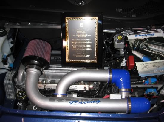

I saw the RSM Racing supercharger in the HHR at SEMA in November. The price sheet was around $4000 projected for the kit at that time. Here is a photo of it that I took.

I also have photos of it mounted on the engine on an engine stand.....If anyone is interested.

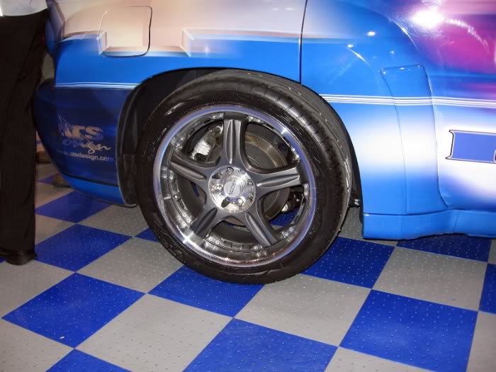

I also found a picture on my pc of the rear disc brakes from SEMA on the RSM HHR...

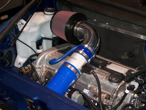

here is the pic of the RSM Intake. This will work on the 2.2 or 2.4 per RSM.

Wow that's so hot. I want one.

ya but that filter is so close to the eng that will just suck in soooo much heat. it needs to be more by the air inlet

I know jack and I'll admit that but couldn't that be routed to a ram air hood?

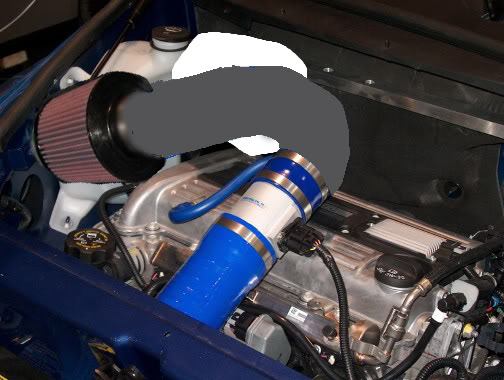

this looks like crap cause i did it in 2 sec but i think this would help out with not getting as much heat

The thing you're not gettting is that the runner length and direction plays a huge part in the overall performance the intake will provide on a given engine. You can't just decide to move it somewhere else without changing the performance values.
The intake we had AEM prototype will mount in the rear also - it's a straight shot with the optimim runner length. This is also the area with the most room for a filter in the HHR engine compartment. Difference: AEM's intake will have a baffle plate to keep the hot engine air away from the intake element!

ya i understand what you are saying in moving it. But if you can route cooler air into it. Instead of hot air that comes dir off the eng. You will have over all better power. Or you could fab up a cold air intake from the fender where the air hole is already
