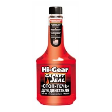

I thought about it
but, it seems to me, the effectiveness of such a measure will not be sufficient
I looked at such a thing
it softens and polymerizes rubber parts inside the engine
but such a measure does not inspire confidence in me either
The sealant between the two surfaces would not be pushed out, because there is no pressure present. The oil you see there can be simply residual from another leak , like the oil pressure sender or the front seal or most commonly, oil spilt from an oil filter change.
The snake oil you posted, could effect rubber seals , but most likely not have any positive effect on the silicone sealants.
